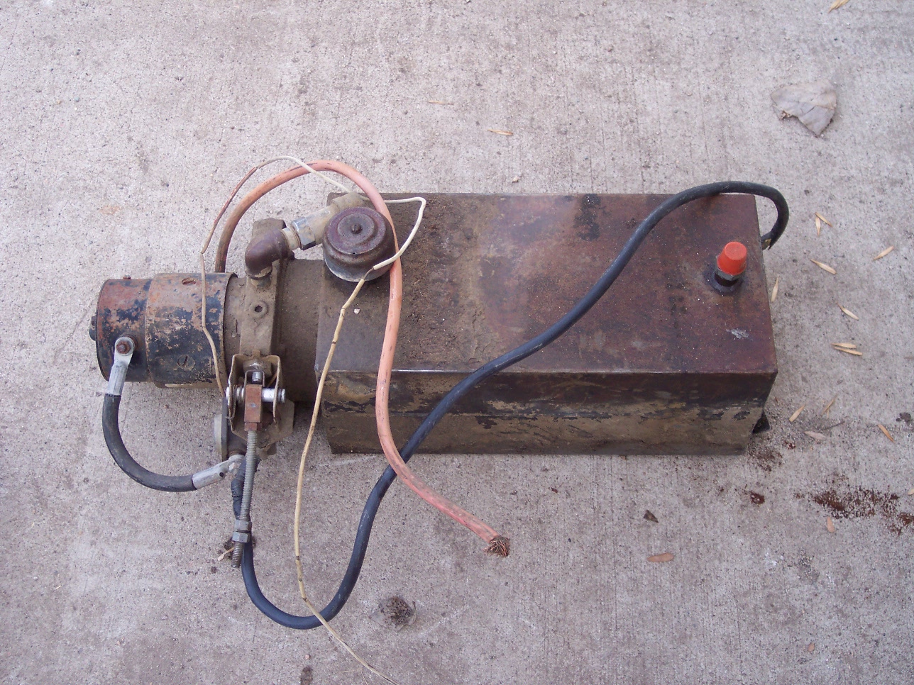

Howdy,
I am in the process of building a dump trailer and my father-in-law gave me a hydraulic pump for this project. It however has a manual control valve. I am trying to see if anyone has done this changeover? I will post a picture in next day or so. Thanks for any input.

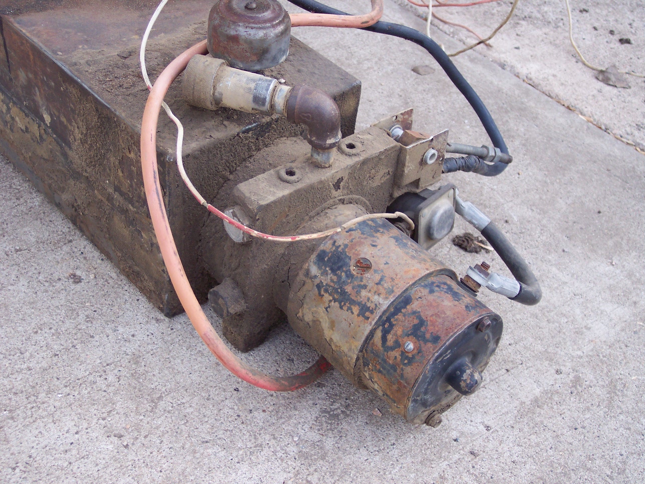

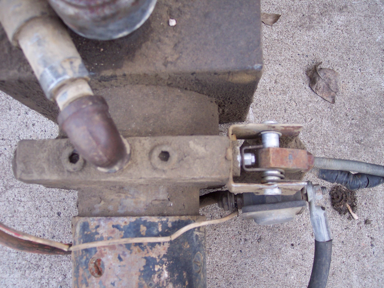

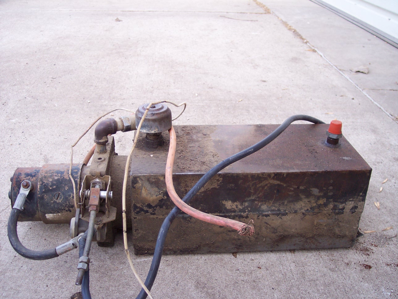

All,
So I took a view pictures. It has quite a bit of ugly but it does work. Any suggestion would be greatly appreciated.

I can't think of any easy way to convert that...Unless you can find a large solenoid or small linear actuator to move the valve.

An easy way would be to permanently lock the manual valve in the open position. Then put a 3 way solenoid valve on the manual valve output. Plumb the common port back to your cylinder, the normally open port to tank (for lower) and the normally closed port to the manual valve output (for raise). There should be an internal relief valve to prevent the pump from blowing up.

Thanks for the input. I am going to try a 12v solenoid which will take the place of the lever.

you can change out the manual control for an electric unit, will require a new spool valve,solinoid and electric control handle. as far as the Dextron , will not be any problems with the summer usage. www.princessauto.com/components/com_virtuemart/shop_manuals/8002286_schematic.pdf
this unit is very close to your unit, i think yours is an older model, check with the manufacture/good hydraulic shop for the parts required. Jim
