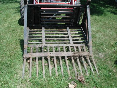

Hi all.
I have almost 9 hrs on my new Kubota L4330 hst. I just sold my old Ford 871 and it is indeed a new world now. My only problem is with the bucket. My old Ford had manure tines on the loader which were invaluable for picking up brush and logs. Does anyone know where I can purchase bolt in manure tines or just the plain tines so I can weld up some easy attachments for them. I can't seem to find them for sale anywhere on the web. Any help is much appreciated.

Welcome to the TBN.
I did a search on "manure tines" (using the 'and' function) and came up with what you might be looking for.
tines
See pics by boiler74 on 6/9/04 at 11:39 pm
Hope this gives you some ideas.
I use my forks to move brush piles. They work great. For some instances, the tines might be better, but the forks keep me happy. /forums/images/graemlins/wink.gif

Thanks, the picture by Boiler74 looks like what I am looking for, although I might need a bit beefier tine. I am having a hard time finding just where I can order these from.
I think the drive shaft might be a little too big for my application. I got lots of hits on my search for manure + tines (which worked much better than "manure tines") but also a lot of false hits. I continue to search, thanks for the advice.

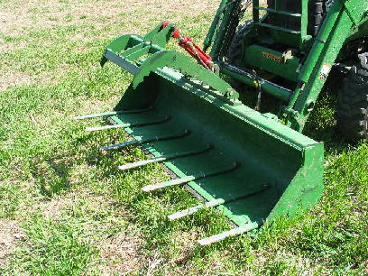

Thought I would chime in, as I've already been a part of the discussion!! My JD tines are spring steel, and pretty beefy. I have bent them some, but they've seen a heck of a lotta' work. I probably bent them doing a little more than I should have. But the spring steel holds up really well. To straighten the really bent ones, I just slipped an old pipe over it, found a nice solid fence post, and bend away. I do have a heavy duty bucket, and haven't seen any bucket damage. But these things are great, and with the added grapple, it's a work horse.
I installed these myself, and you might want to have a couple of extra drill bits at hand, and some spray lube. Took a little over an hour.
Attached a pic.
J.

   / manure tines #10
Are they welded on or bolted on? Drilling, must be bolted on. Are they used parts reclaimed, or new pieces of spring steel, and what dimension?
Thanks
They look good as do the car axles.
