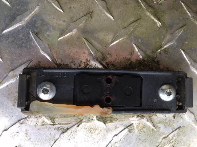

I need to change this marker light on the horse trailer and I can't find anything to lose these bolts. I have a couple screw driver sets with every bit under the sun and I tried hex wrenches both metric and SAE. Any thoughts on what fits these?
   / Marker light bolts
#2
Never mind. I just found the bulbs to fit this so I don't need to remove it.
   / Marker light bolts #3
looks like a torx bit
   / Marker light bolts #4
If I remember right, these are Philips. Trailer manufacturers use these for assembly because the drivers are easy to center in them. Try a Philips #2. It's either Philips or square bits.
   / Marker light bolts #5
They are square drive (Robertson). They look like Torex, but are 8 sided. 2 squares 90 degrees off so the square drive fits in 2 different positions.
Never seen square drive with the holes 90 degrees off. That is the one driver I did not try.
   / Marker light bolts #7
Like Fallon says, use a square bit, a #2 if I remember correctly. I had to remove some screws for something on my enclosed trailer and this worked like a charm.
   / Marker light bolts #8
I ran into them on my Haulmark trailer replacing a side panel. They are called doublesquare and you can get 8 pt bits for them.
