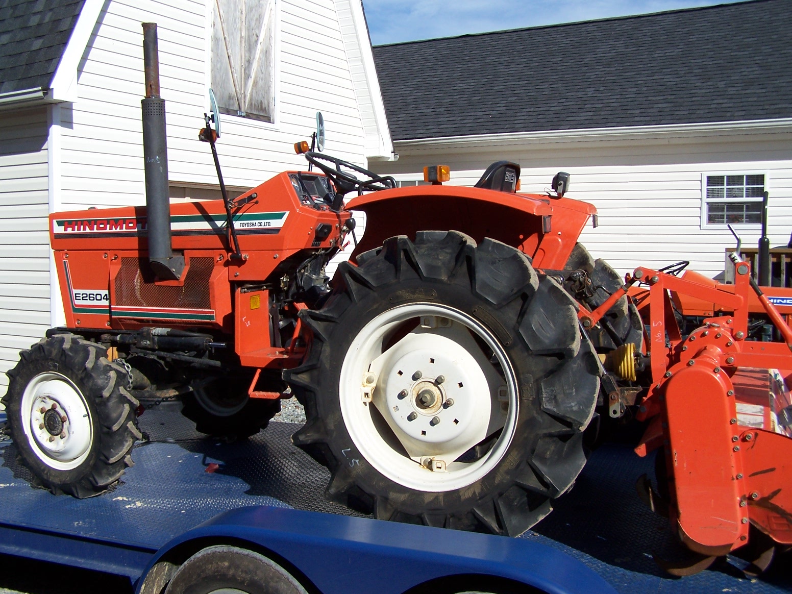

For the record, this is what a 31hp Hinomoto looks like.;)
