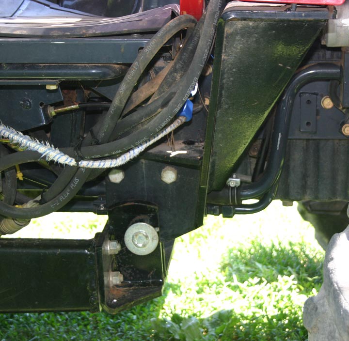

Hi i was wondering if anyone has a 1200 series Massey tractor with a Massey FEL?
I would like to see some pictures of the support arm frames. My tractor has a woods FEL and I don't like how the monts are attached.
Thanks Phil

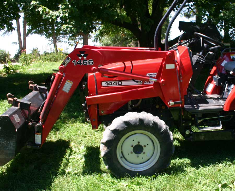

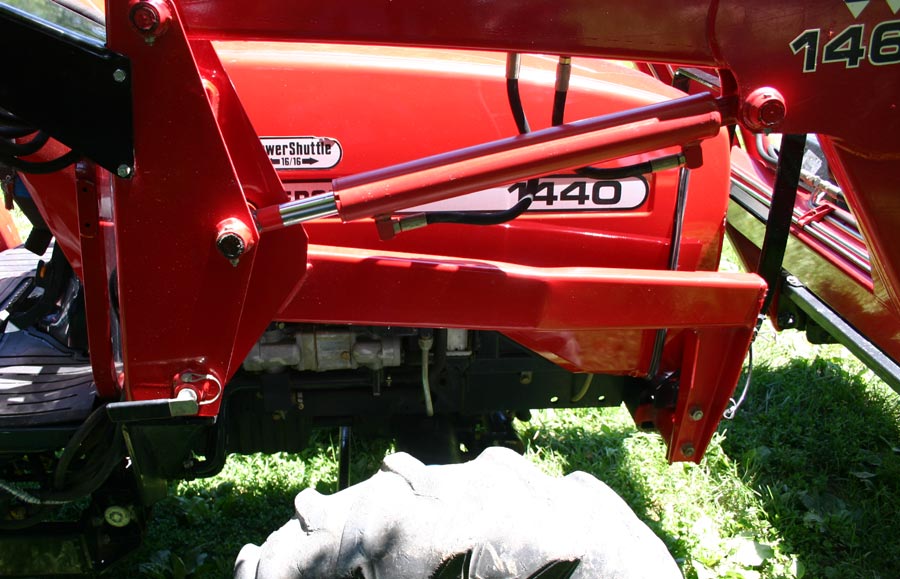

Jerry if you could take some pics of the frame that attaches the fel arm supports to the tractor that would be great. I did notice in your picture that the renforcment bars going to the front of the tractor are lower than the ones on my woods fel.
Again thanks for the pictures.
Phil
   / Massey 1260 with factory FEL #4
We'll see if these will post. My computer doesn't like to put pictures on TBN for some reason. Let me know if those were what you were looking for.

Jerry,
that is exactly what I needed. I noticed that your FEL mount brackets are bolted to the trans mount holes and not part of the platform supports.
Also the arms that go to the front of the tractor are welded and lower than mine. That looks to be very stout. I think I will try to modify mine to be simular.
Thanks
