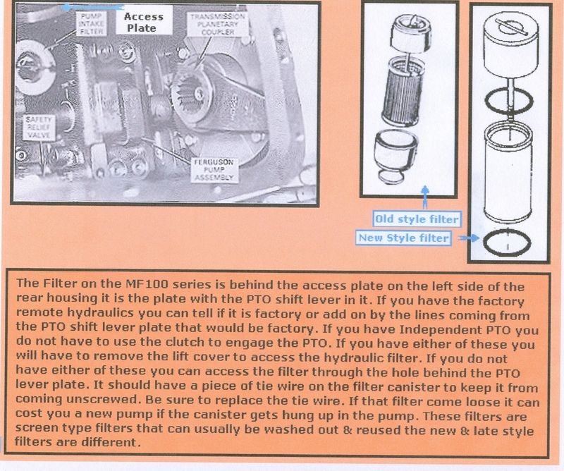

Hey everyone! I recently purchased a MF135 and wanting to change the hydraulic oil as it is milky white. What is the best/easiest way getting to the hydraulic filter?

your filter is located in the bottom of the center housing, see if this helps -

Thank ya!
