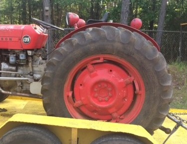

I recently purchased a MF135 with 4 rail power-adjust rims. These are 28" rims and I believe they are 12X28 based on the tire size (13.6 X 28).
I am going to have to replace the rims and possibly sooner rather than later. I am wondering if I can replace them with rims that are not power-adjust without replacing the centers, or am I going to have to get new centers and rims to get away from the power-adjust?
Thanks in advance!

You will need centers for non-PA rims. The good news is that used centers are dime-a-dozen since they are rarely damaged when rims rust through.

Figured as much looking at rims that were available and great point about a used center. Any idea what a reasonable price is to take the tire off the old rim and mount on a new one?

Are they only rusted where the valve stem is located? I saw my dad do it once when I was a kid and I've done it on three other rims, but cut a section of the rim out, find a donor rim and cut a patch to replace it.
