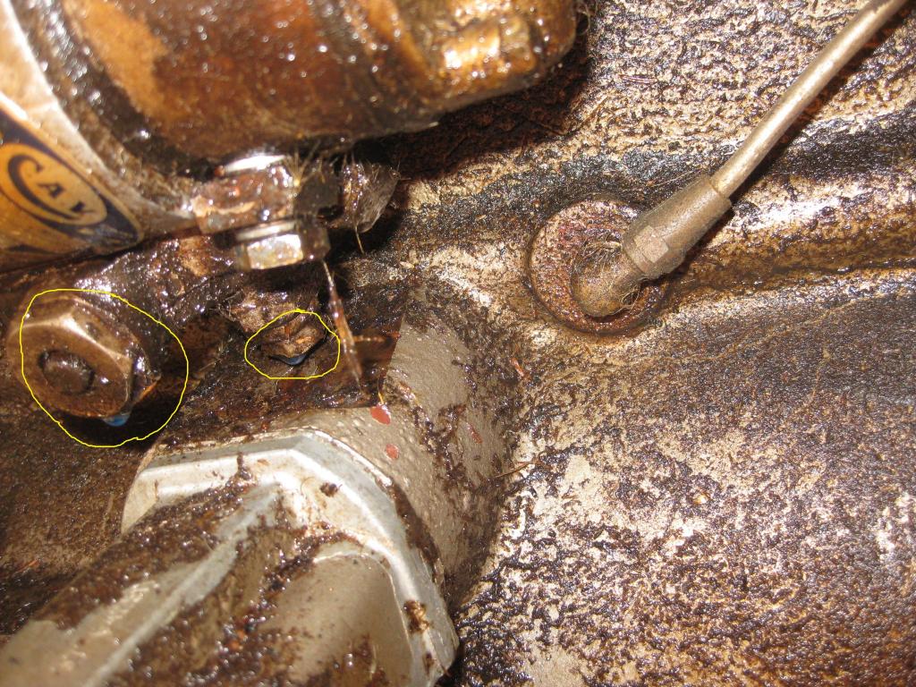

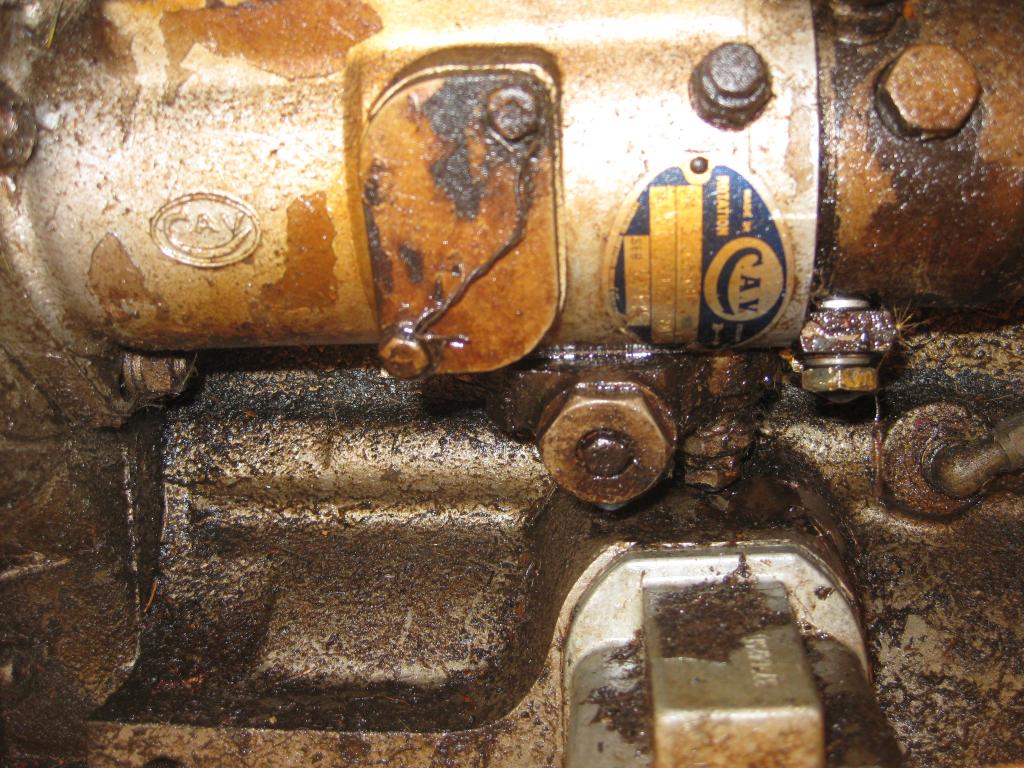

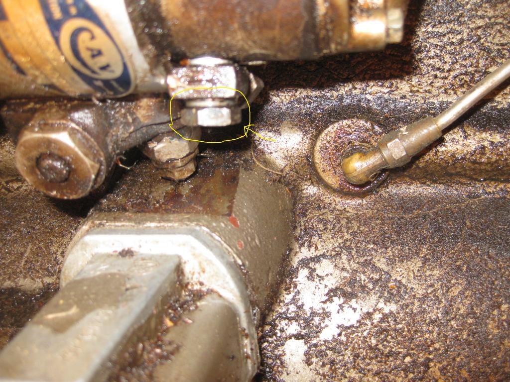

My Massey is leaking from these places and I have tightened the bolts, however I can't make it stop dripping. There is an injector pump place in Mt. Vernon that comes highly recommended for a grand or so to rebuild, however I'd love to avoid that if I can, as the tractor runs great. It is a 1975 Model and no I am not a mechanic, though I can huck my way through stuff from time-to-time.
Any suggestions?

Those leaks are fixed by replacing rubber "O" rings or copper washers. Don't need to spend $1,000 for no reason.
Have a look at the label on the injection pump and let us know what the pump model is. It looks like a DBG model rotary fuel pump - if so it shouldn't be too hard to fix.
How bad are the leaks anyway - just steady drips ?
I worked on mine and fixed it for about $40.

It's hard to see where the leaks are. Sorry, now I see that the pic is three and not just one. Can you spray the area in question with some brake cleaner spray and air dry it, then show where the leaks are located?
The area you circled looks like it takes a copper crush washer, possibly, or a similar type, as suggested by doxford jim.
Hope you get it sorted for low $'s.

The shop is called Performance Diesel 800.698.1902 they have a website and are in or near Mt. Vernon.
The tag on the pump:
CAV
DPA 3233F670
SET WW48/900/2/2390
SER 5224 and maybe a letter behind that number, it's hard to say, can't really read.
The leaks are steady drips every 3-5 seconds.

You can ask the shop to reseal it, kit is about 30$ plus labour. Unfortunately most shops I've encountered will only do the rebuild for a grand.

You probably only need a seal kit (including copper washers etc.) for about $40 or so. If memory serves, US Diesel has a minimum charge of somewhere around $60 maybe more, don't know for sure.
Anyhow, read the manual and I think a seal kit is probably all you need.
