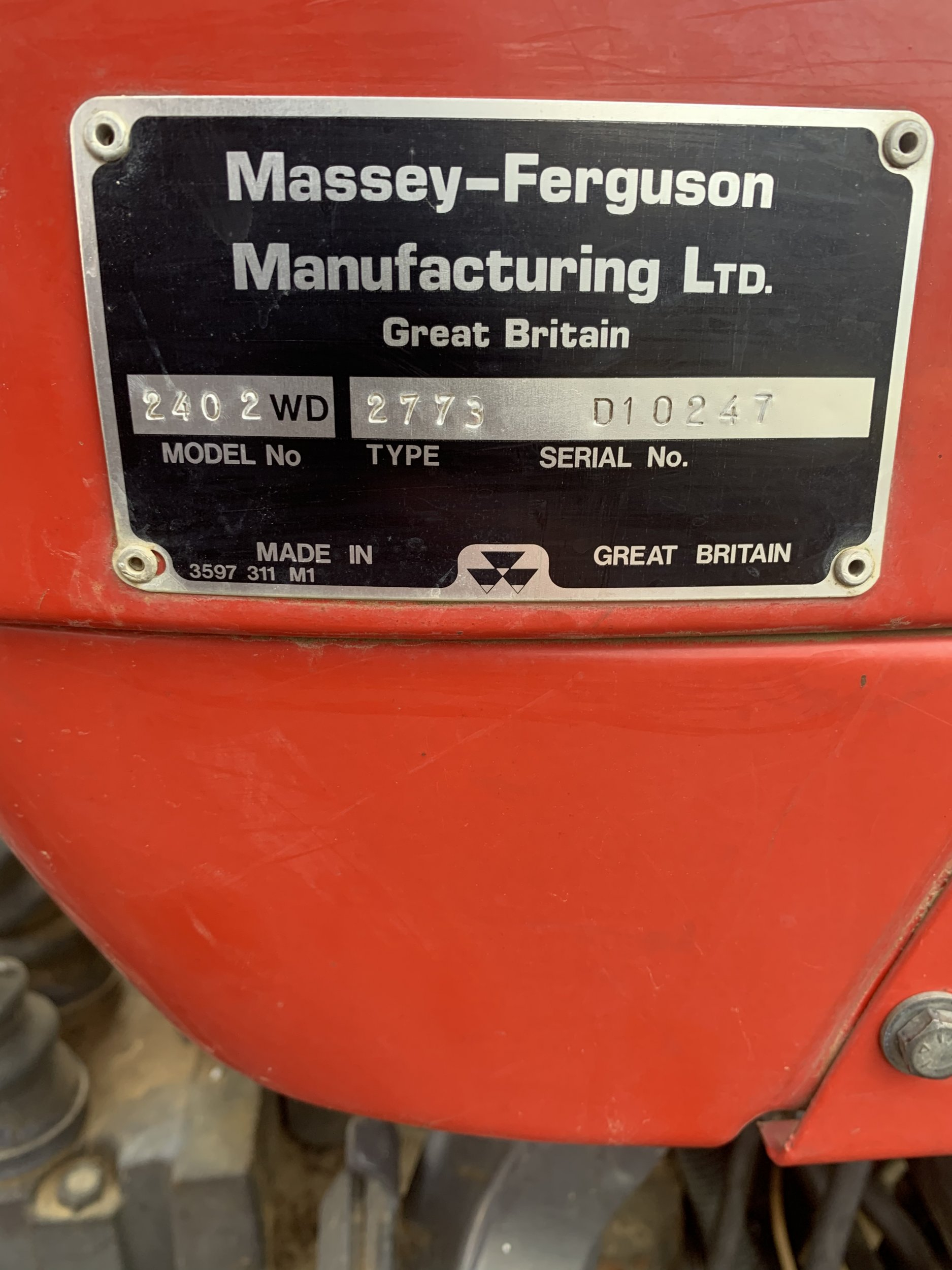

Hello everyone, I have an older Massey 240 that will not start previous owner shut it off and it never started back for him. After checking the tractor isn’t getting fuel up to the injectors. The upper and lower port on the injection pump(Cav pump) is spraying out a decent amount of fuel from the bleed ports. What steps would y’all recommend next? I’ve bleed the system multiple times trying to get fuel to the injectors.Is there any ways to diag the injection pump? Also attached the tag on the tractor. Thanks!
