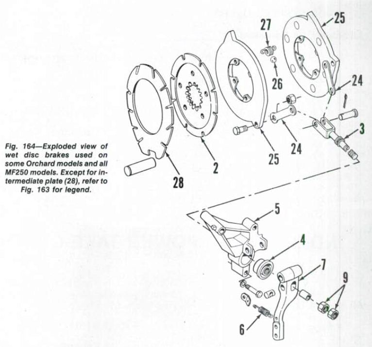

I can't answer your question but when you find the answer let me know. Here is an exploded view of the brakes. This is for the 240 orchard models or MF250
Service Manual

Blunderbore , that's the diagram. Make sure the pivot pin in #5 is not froze in the bracket or the actuator arm. Apply the brakes and then see if you can push the arm back.
If they don't go back with the springs, you will have to take them apart and clean, then grease the pivots. Take the adjuster nuts off of #3 and then remove the three
bolts in #5 and pull it over #3 rod. The gaskets weren't much and I'm sure the rubber boots need replacing. They can be had anywhere as they also fit a lot of Ford
models. I drilled a hole for a zerk fitting in the actuator arms into the crosspin bore. It now gets grease every time. This is really a good design, it just lives in a hostile
environment. I didn't mean to hijack the thread, but I just went through this last winter.
