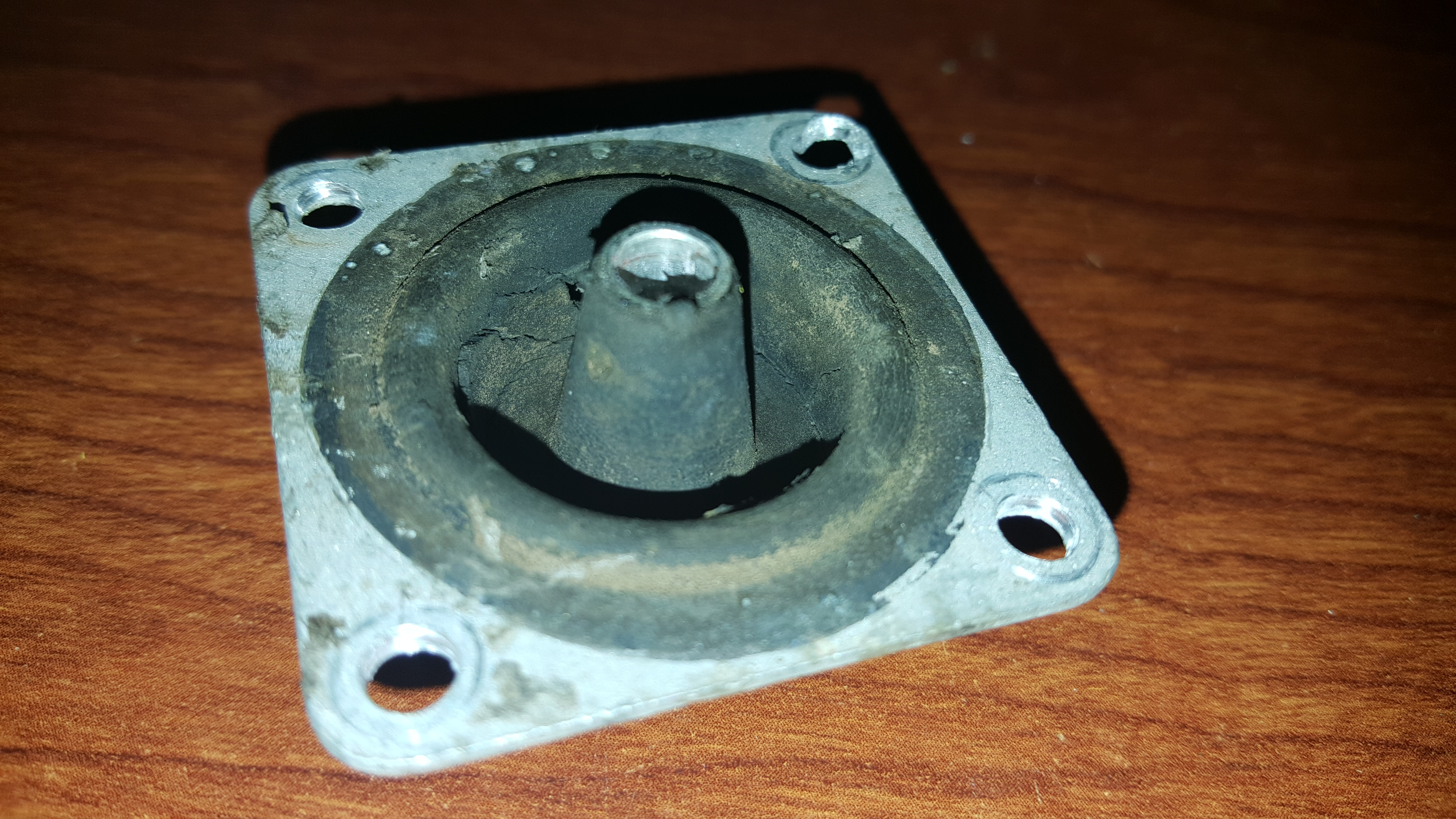

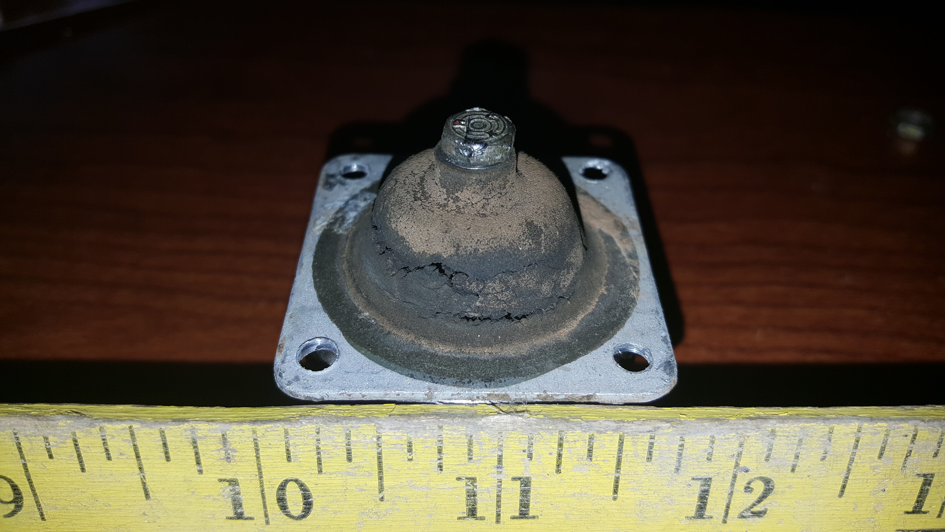

Greetings,
I have a Massey 271xe -- 2002 Year (I believe).
The gauge cluster (mounts in dash panel) is mounted with (4) rubber gadgets (anti-vibration) ...
-- The mounting "gadget" mostly a "rubber" part ....
> Hole through the center allows a 3/16" bolt/screw to fasten it to the main dash panel.
> The other end of the "Gadget" is an Aluminum Plate (1.76" x 1.76")...
> plate has (4) small holes (1 at each corner) -- about 0.16" diameter ... these holes "pop-rivet" to the Gauge-Cluster-Frame
> That aluminum plat has a "large" hole in the center (about 1.25" inch)... the rubber is fused to the aluminum plate in this hole.
-- Part Number --- I need the part Number..... and any advice on where to obtain.
Massey Ferguson dealers used to be common around where we live... and they can't hardly be found anymore ... I have contacted the closest dealer... but I haven't hear back.
*** The rubber is "rotton" on my mounts... and they are all loose... need replaced.

herrmc:
Yours appear to be in much better shape than mine on a 251XE. I did not drill them out, but replaced the inner parts with 2 different diameter automotive hose sizes between some larger washers so the panel could move back and forth through the mounts. A year later it is still working..

--- Thank you for the response!!!
--- the picture is deceptive regarding the condition ... they are actually all apart in little pieces... I assembled that one back on my desk (from the pieces) so I could have picture of what it should look like :)
--- That is a good Idea about the hoses .... I was thinking of using small springs. I have a machine shop, so making some stuff isn't too big of a deal...

   / Massey 271xe - Dash / Gauge Cluster Rubber Mounting gadgets
-- Thank You for the link to the parts book!!! ... this is very helpful.
--- I found my part on page 348 of the 271 XE book
Item #7
Part Number = 3609301M1
Description = "Damper"
Qty Required = 4
-- this is going to be very helpful!
