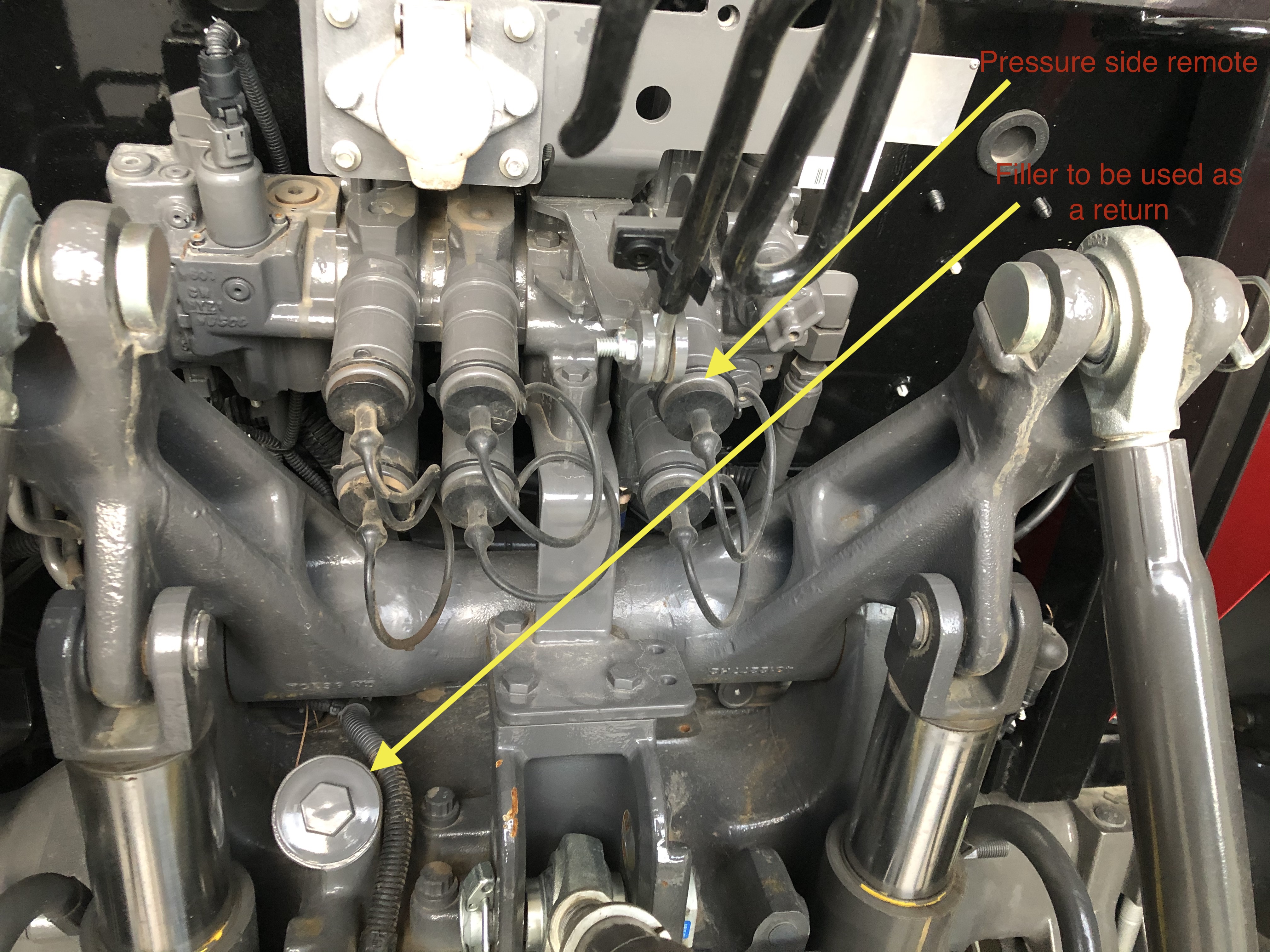

Curious, does anyone know what specific fittings I would need to hook the return line up to my hydraulic fill on my Massey 4707? I壇 like to do it in a clean manner.
My tractor is to be returned to me shortly and I would like to get some parts in route. Thanks in advance!

I believe that I don't have the clearance to put an easy return fitting because of my lift arms. Has anyone found anything that works on a 4707?
   / Massey 4707 / Shaver HD-10 return fittings #3
Shaver May be able to help. They have some parts and return fitting suggestions that are tractor model specific.

Talked to your dealer and check how it's done from the factory? They might have a retrofit kit.

Yes, Shaver was a big help... If anyone has a Massey 4707 and wants to use a Shaver HD-10, the part is the SM-16-RT adapter available from your Shaver dealer.
Both the dealer and Shaver had the wrong adapter. The SM-16-RT will not work... For the 4707 it is 1 5/8 NOT 2 inch.
