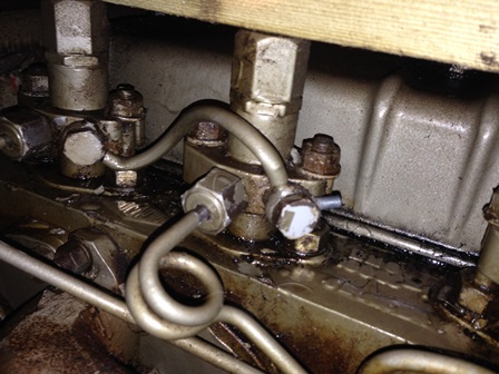

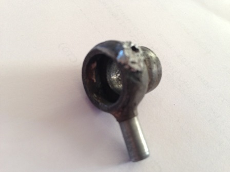

I need some urgent help. I have a massey 65 tractor that has been restored some years ago and i need a replacement leak off banjo part that was broken during a repair.
I am not sure of the model of the injectors hence why i need your help! part1.JPGpart2.JPG
Thanks Mike
   / Massey 65 - Leak Off Banjo Part - URGENT #2
Part number 731187M1? Take the serial number of the tractor to your local dealer. They should be able to help.
   / Massey 65 - Leak Off Banjo Part - URGENT #3
With the right size tubing you can make up a new return line teat with existing banjo fitting.
Those ends are just soldered onto the fitting much like copper piping in your house is.
