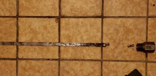

. I fished the dipstick out of the hydraulic tank on a 220 FEL on a Massey Ferguson 203. I believe a 220 FEL. Tags gone off of the loader frame hydraulic tank. There is a short ball chain that goes between the filler vent cap and the dipstick.
The dipstick in the photo hangs from a short chain. I'm missing the chain and need the length of just the chain.
Thanks Mike

Well I guess that style dipstick didn't hold up well. There are probably not many left. I had the little chain but cant find it now.
I remember it being about 3" or 4" long. Ill get a chain that's about 2.5" long and a little stronger. That dipstick isn't heavy but I don't think that ball link chain is very strong. Making it a little shorter than I remember will assure a good fluid level. That will make the dipstick low level mark about 4" above the oil pickup tube for the pump.

You unscrew the vent cap. The dipstick hangs on a short chain connected by a pin going through the fitting

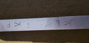

A photo of the marks that don't really represent a lot. Both marks are about 7 to nine inches above the pump suction tube.
Its not like an engine oil dipstick tube. Not as critical.
I just went up and did some measurements and have decided to hang it from a three inch chain and a swivel. That leaves about 12" of air space above the full mark. About 8" of oil above the suction tube to the low oil level mark.
If I had thought more about it earlier this is one of those situations where { close} is good enough.
An inch or two either way wont hurt anything. Keeping it above the low mark will work

I misread your question. I used a telescopic magnet on a string. The loader frame is off of the tractor. I'm cleaning it up to paint.
Found cracks to weld.
