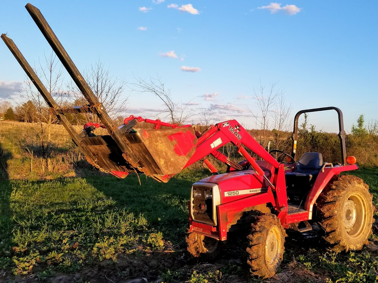

Weather this coming weekend looks like a good time to do maintenance on my Massey Ferguson 1250
Can someone who has one share their list of fluids and filters that they use/prefer?
