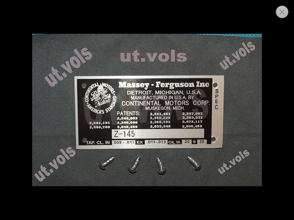

The early model 135's round side emblem on the North America versions (rear mounted emblem) where chrome plated. This was a single stage plating and unless well polished would later in life pit and flake off. Later they went to a baked enamel painted version. Same with the front emblem. The older version has a rolled aluminum horizontal bar that went across the top grill. The early emblems where also single stage chrome plated and was secured to the aluminum bar with twist caps. The side emblems where also secured with twist caps. 1/4" I think.
A few clues to vintage. If it has a vertical air filter then it could be a 65 to 67. They where ordered where heavy dust and debrise filtering was needed. Pain to clean out. Earlier models such as my 65 the serial number was mounted on the battery tray frame on the left side. Later models where mounted on the dash metal in front of your left knee. If you see holes missing in either place that would be where the serial number was. The engine if it where a 4 cyl continental the plate would be mounted on a flat surface on the left side of the engine block to the right of the distributor.
The picture attached is for a Z145. I had these made to replace my badly damaged one. One can't get a fix on the age of the tractor from a engine number plate. You have to have that all special serial tag mentioned. My only suggestion to you is to compare parts with known tractors to narrow down to a date. Good luck.
