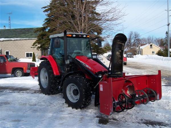

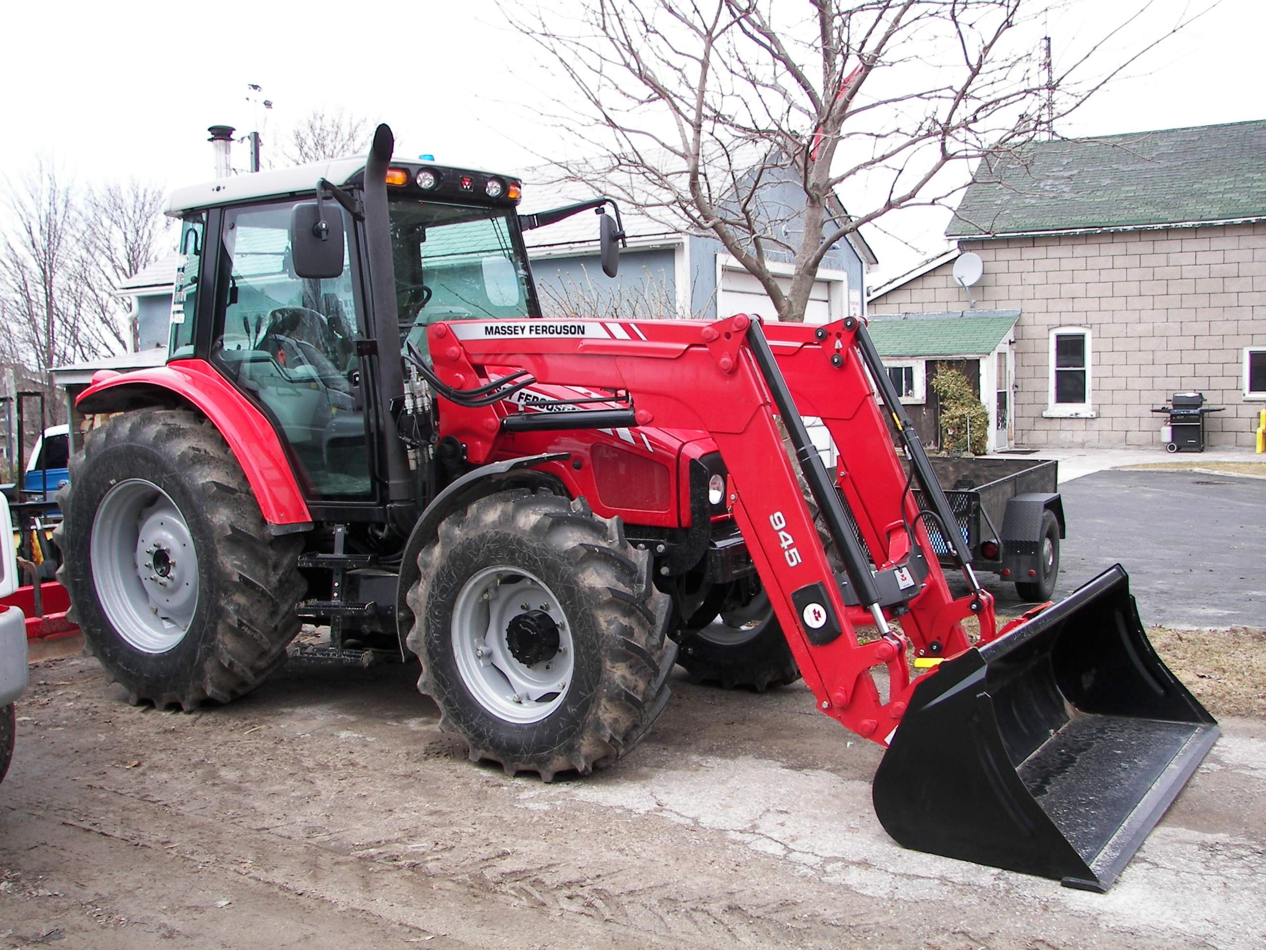

I am in Landscaping and snow removal and had a 1547 cab and loader, but hydrostatic (love the hydro for a lot of loader work) and was pleased with it's performance, especially the lift capacity of the loader and 3 point hitch, I just found it to light in horsepower for snow removal, so I traded up to a 5455 Massey. I really like my 5455, but it's a little big for landscaping (great for moving skids of material around) so I just bought a 1533 cab, loader and again hydrostatic. I am pleased with these tractors, good work performance, and they seem to stand up well, for the 3 years I had the 1547, I never had it back for any repairs, mind you it only had 700hrs when I traded it. Sorry can't answer the loader question, although I'm sure there is an aftermarket company building a SL loader for them. Here's some pics of the 1547 and 5455.
