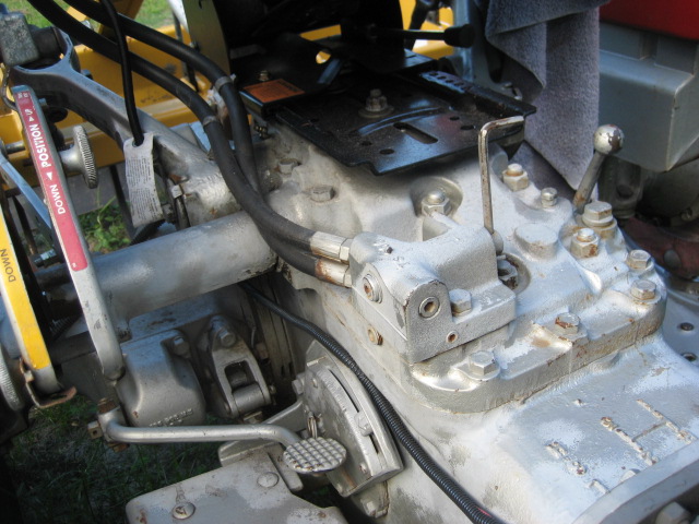

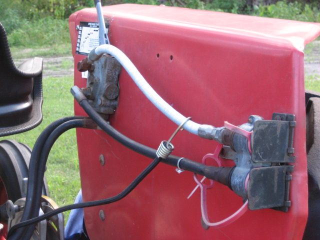

Attached are 4ea pictures of the remote hydraulics on my 165 diesel. Is there any document online that I can download and/or purchase on how to operate them
Thanks for your previous information

From what I see is a valve controlling the fluid to two QD's, and the supply for this is coming from the valve with the hex key.
Plug a hyd motor or a cyl into the QD's, and activate the levers and see what happens.
Check out the connection with a plug in hyd gage with a QD fitting .
You may lose 3pt operation in one position.
There may be three position on the valve.
