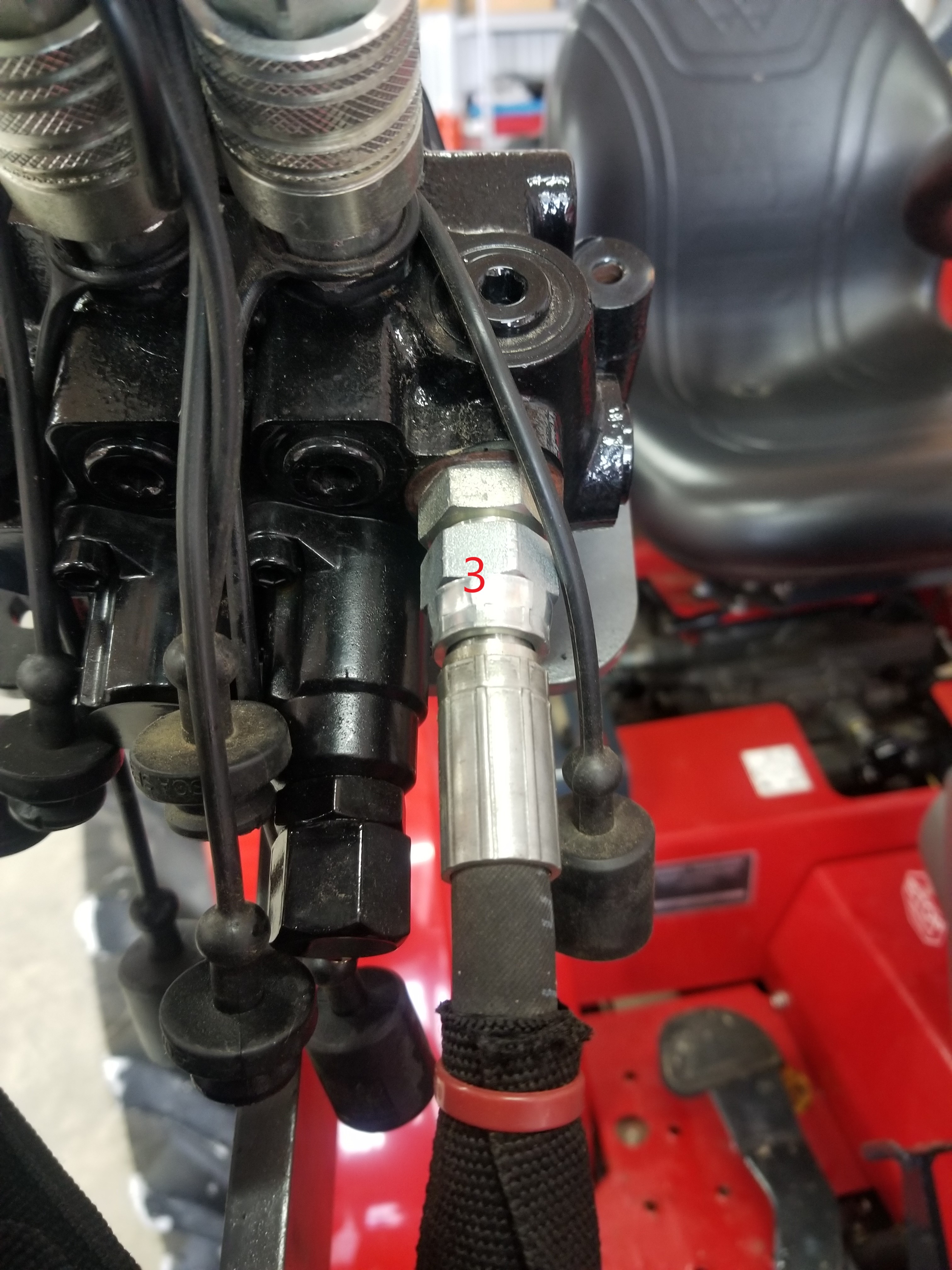

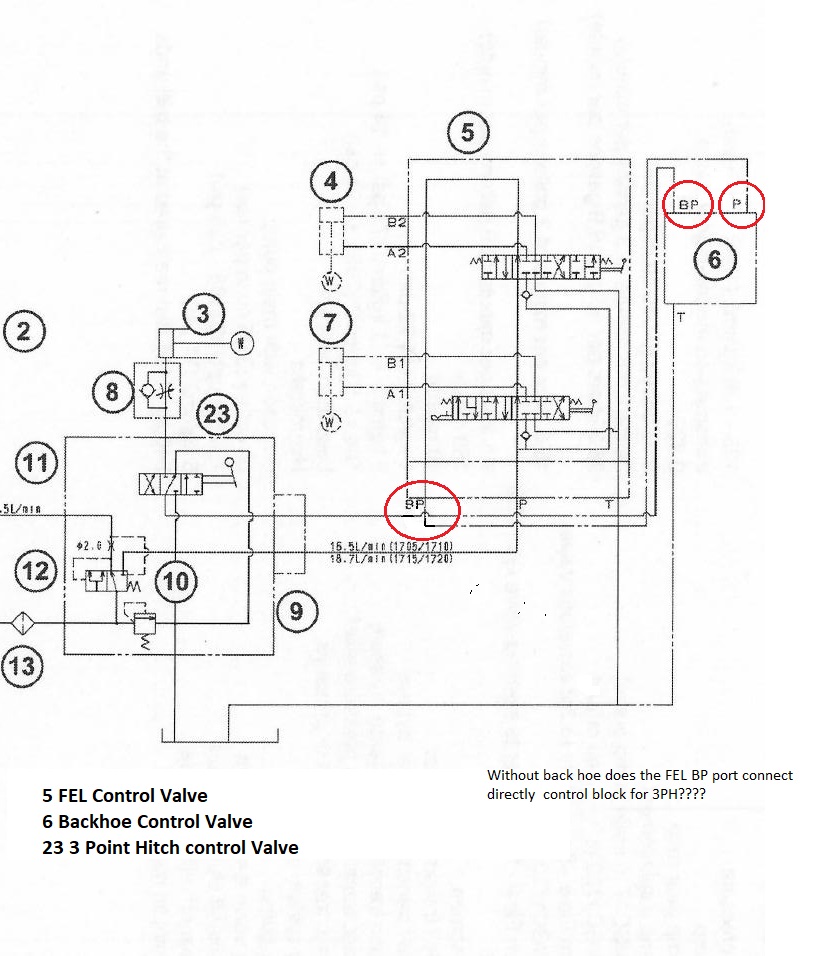

It is unusual not to have markings indicating ports. However, I am fairly certain what I posted is correct. If you get the kit from EA, they will confirm on proper way to install.
I know you can do it cheaper sourcing parts separately, but a kit for your tractor takes all the guess work out of it making things much simpler.
   / Massey Ferguson 1734E Line ID
#12
Thanks again for all the help
