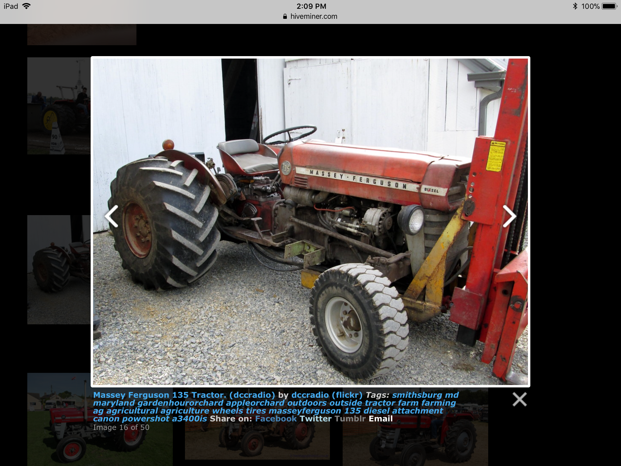

   / Massey Ferguson 235 front rims #2
Does it look something like these?

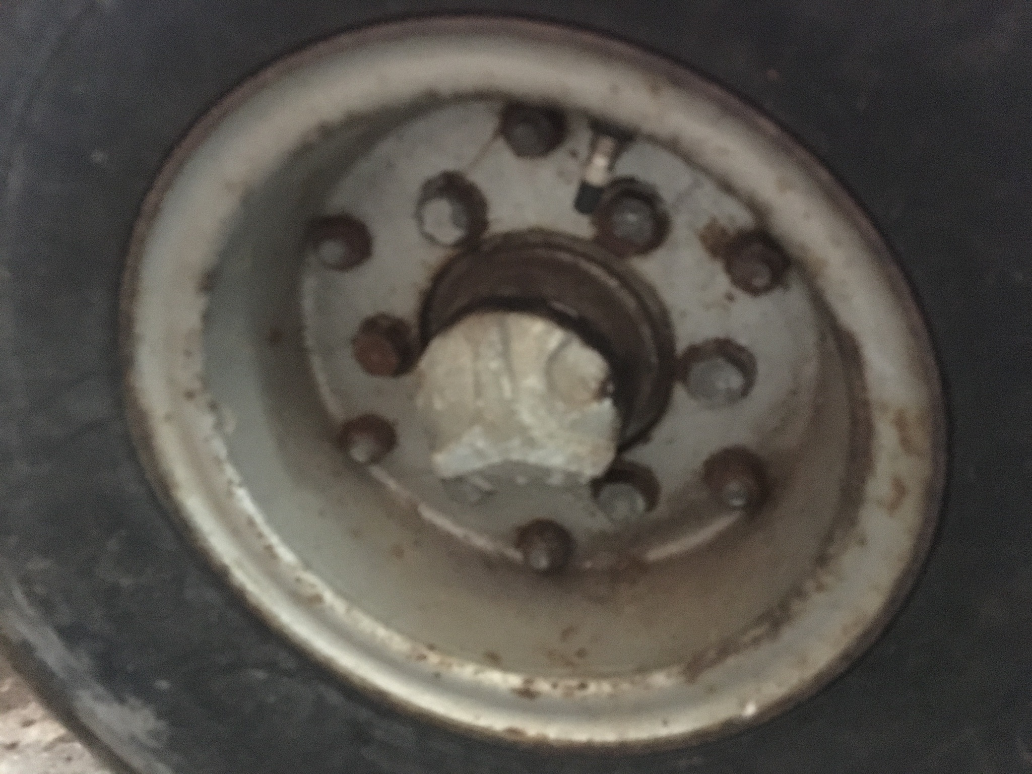

   / Massey Ferguson 235 front rims #3
Here is a picture of one of mine.
