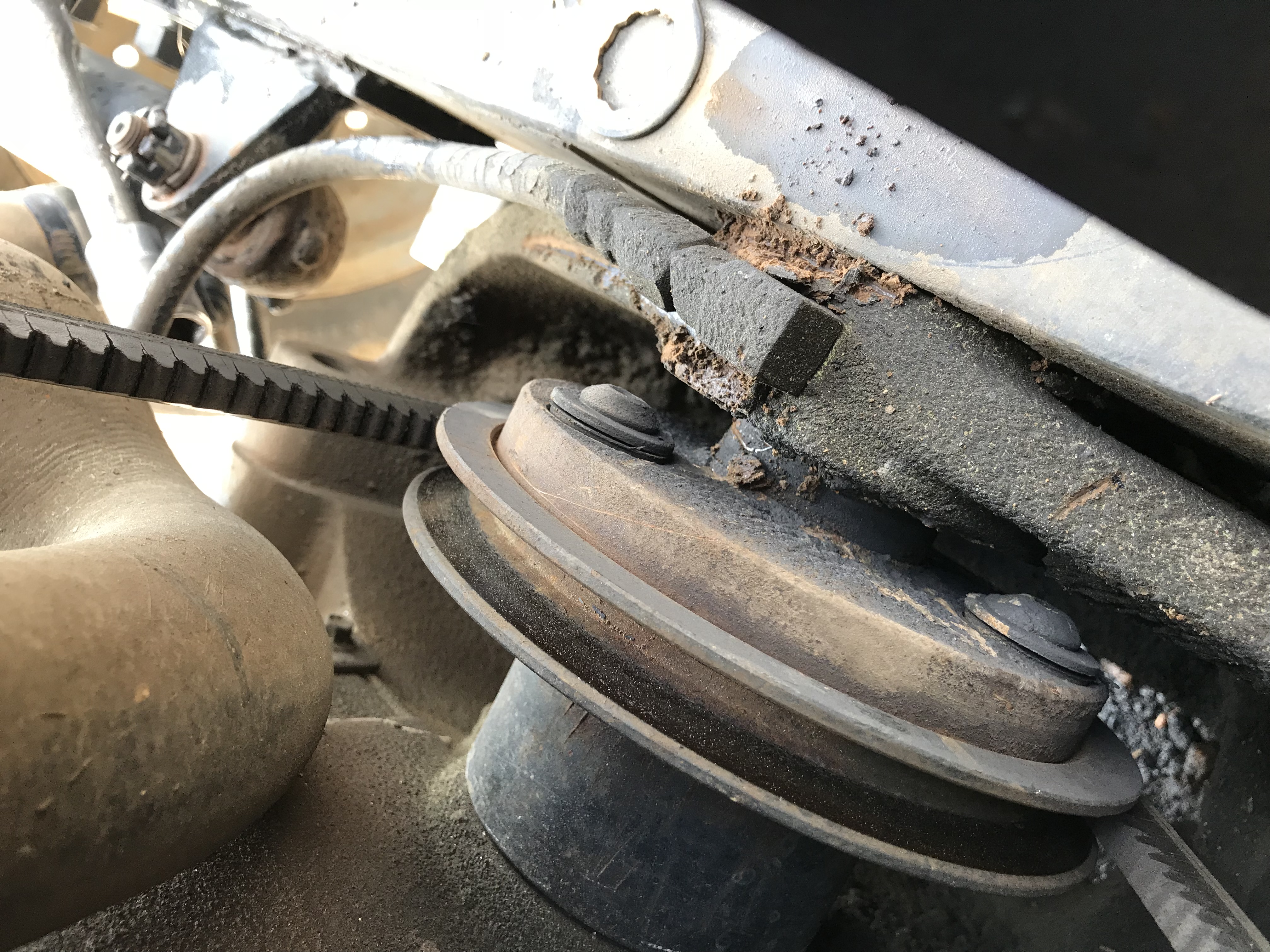

I have a Massey Ferguson 240 tractor with a 232 front end loader. The flexible shaft that goes from the forward pulley to the pump has the splines worn off, so that it will not drive the pump. To get another shaft (non-flexible) requires me to give the supplier the length of the old shaft - and there's the problem.
The shaft screws into the pulley with left-handed threads, but has been in there for so long it's probably rusted in. Short of dismantling the front end, how do I get the shaft to break loose (the flexible shaft kinks with heavy torque).

When I did mine I had to take the front of to get the adapter plate of the pulley then put the adaptor plate in a vise and used a torch to heat it up enough to unscrew it. When you replace the new shaft put lots of never seize on the threads.

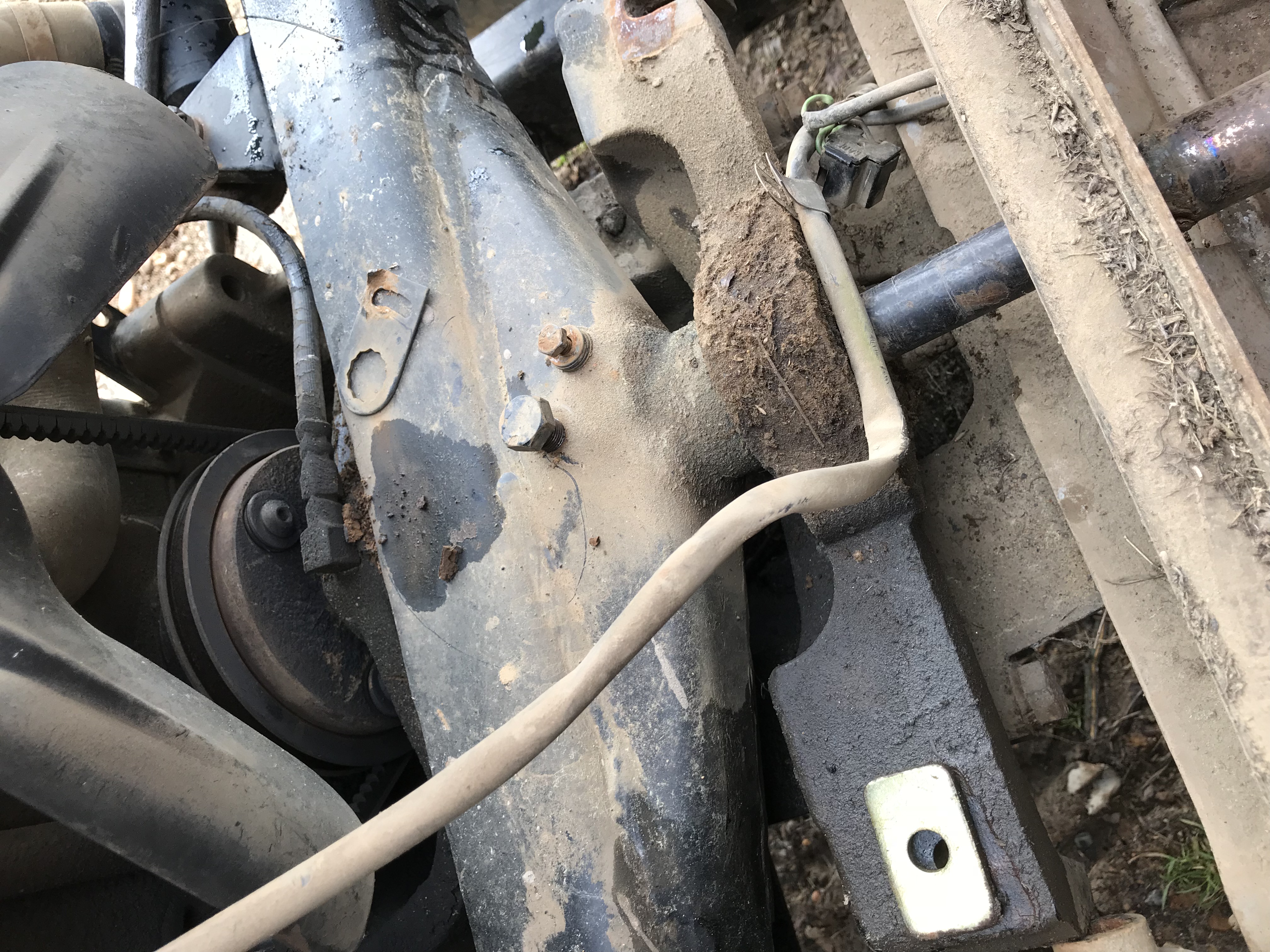

Here's my solution (case resolved)
it took two men with "cheaters" to break loose the shaft - it was left handed. It just took tremendous force.
Once the shaft was loose, I purchased a small spline adapter and had it welded to the old flexible shaft as a replacement. It worked!
One problem - the set screws (as on the old adapter) ARE needed to keep the adapter from disengaging when considerable torque is applied, as in a large load.

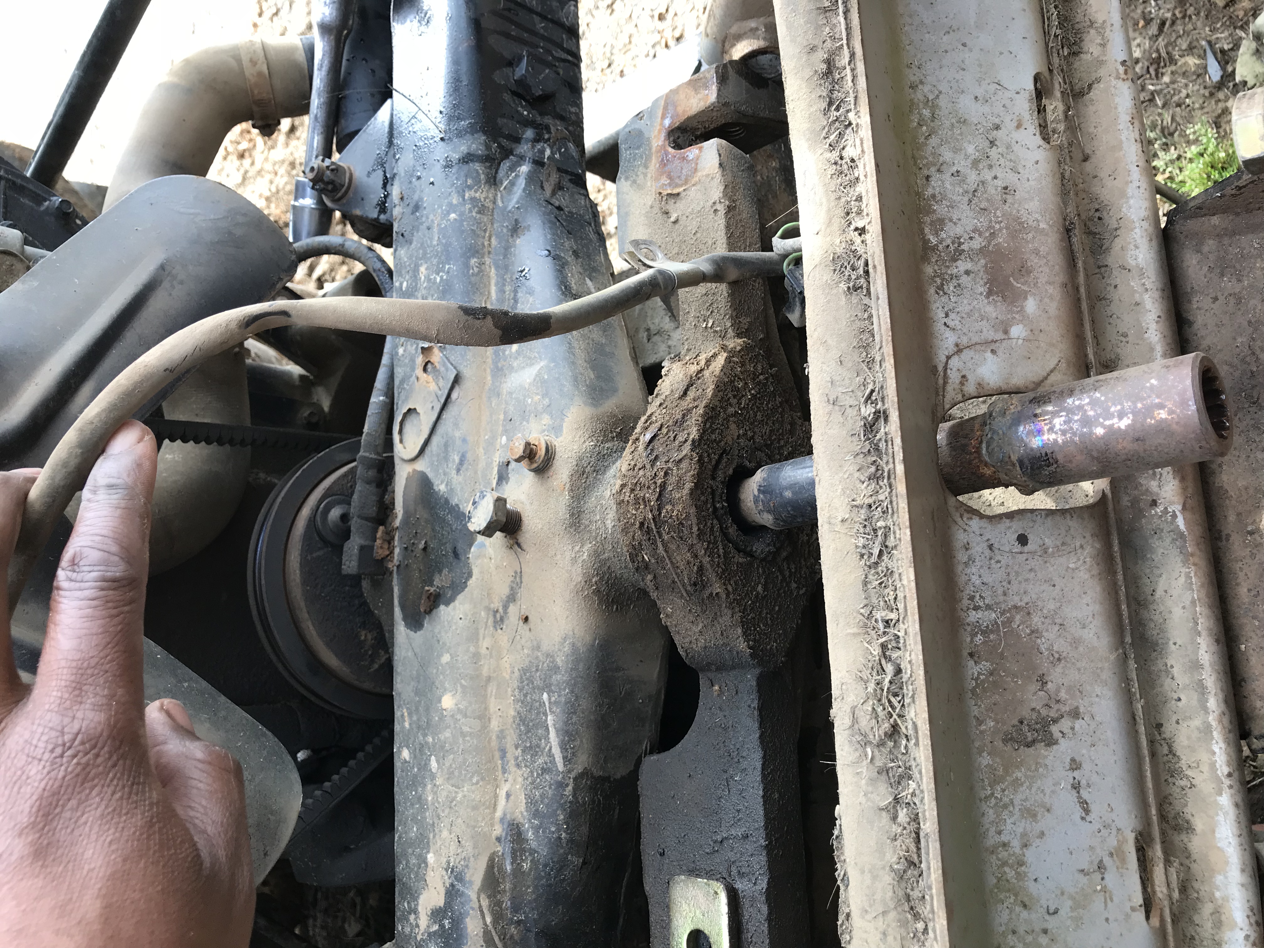

Where is the set screw located? My shaft have mess up and I can not pull it off. Do I have to remove the front end of tractor.
