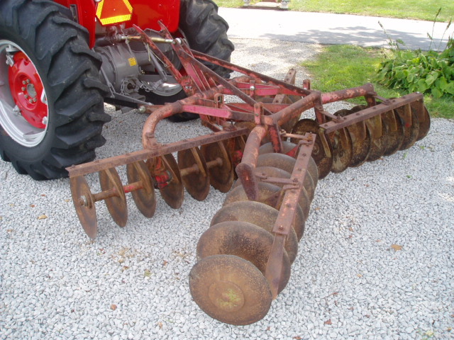

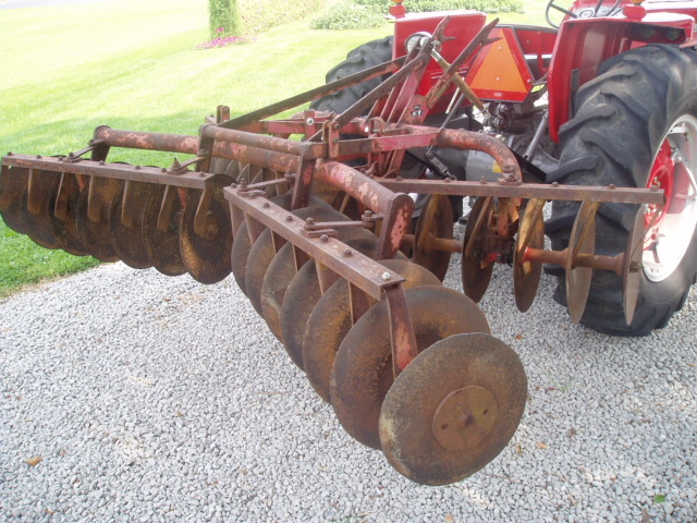

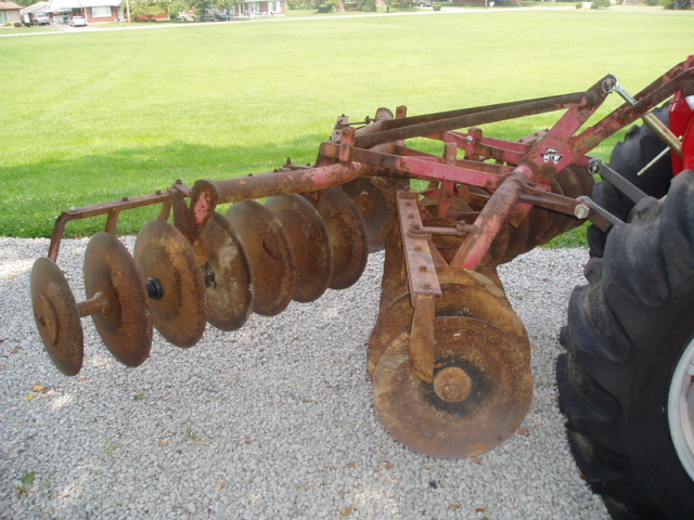

Where do I begin.....
Back when I bought my MF 150, it wasn't ever intended as a tillage tractor. I had a 5000 Ford then, later replacing that with a 2440 Deere. I never once hooked a disc to the 150. Had I, it would have been a model #25 MF disc. That was the best 3-point disc available back in the day when smaller tractors were still used as primary power on smaller farms. Time marches on.
So, I finally quit farming for the most part. I'm just playing now. I thought it would be nice to find the plow and disc that would have matched up to my 150. Still haven't found the plow. (model #66, 2X14" or 2X16") But I DID find the disc. Searching a local "classifieds" paper yesterday, I found one. It a bit rusty, but intact, and ready to take to the field. In fact, I disced the sweetcorn field today when I got the disc home just to see if everything worked. And it DID!
This winter, I'll dismantle it, sandblast everything, prime, then paint. New decals are on the way. I even found the serial # on the frame and I'm having a stencil cut to paint it back on. Obsessive? You bet! Gotta have it PERFECT!
Here's a few pictures of (IMHO) the best 3-point disc ever built. This one is a 9' model.

Don't recall seeing one quite like this 25.
Looks like it has some kind of setup to scrape the mud off the discs.

Back in the day when the 100 series Masseys were new, they sold like hotcakes in the Kentucky/Tennessee area. Small cattle and tobacco farms of the day made good use of them. The implements that sold along with them were quite popular. The #25 disc was a favorite. So. You'll find a lot of them in this part of the country still. Most of the #25's were either the 6'-6" version, or the 8' model. This one I found is a 9'-8" version. The biggest of the #25's. It gives my 150 a workout in plowed ground, but she'll handle it OK. Weight-wise, it's about the same load as my Bush Hog, so that isn't a big deal.
The #25 came standard with scrapers as you noted. In clay soils, ESPECIALLY in fresh plowed ground, a disc will pack up with dirt between the disc blades without something to keep 'em clean.
Also, the #25 has a bolt per each gang that can be removed to allow each gang to float. On rough ground, that keeps the disc from "bridging" over high spots. Those 2 levers you see by the hitch allow you to change front or rear gang angle while on the run.
I've got 850 lbs of "pasture mix" grass seed in the barn, and my seeder lubed and ready for action. Next tuesday or wed., I'm starting to disc 28 acres of pasture for re-seeding. After that, the #25 disc will get dismantled, sandblasted, epoxy primered, painted, decaled, then start the long proccess of letting it get old and rusty again.
