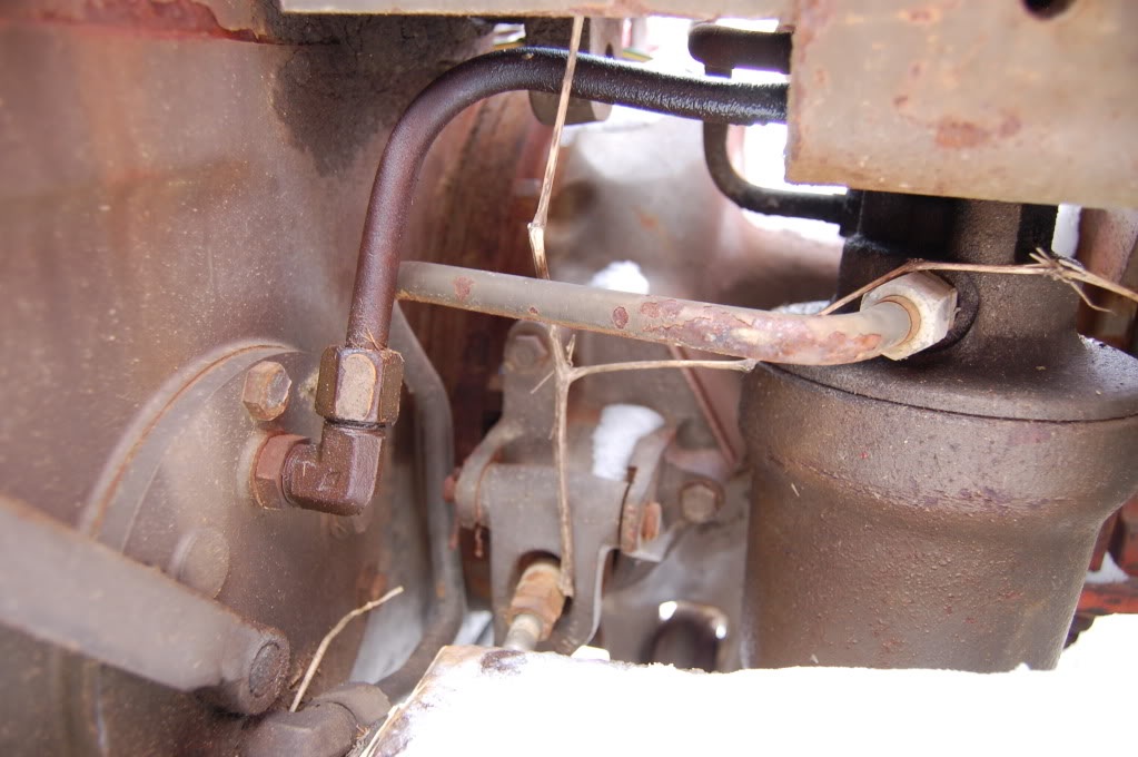

Hello all, I have an older Massey Ferguson 255 tractor that I just refinished . I purchased on older fel that should fit with a little fabrication work, I think I have that area covered. My questions are on the hydrolics. I do have two remotes but would like to utilize the main pump to operate the hydrolics . I wil include a picture of the exterior lines from the pump. I am not sure which is the feed line and which is the return. My other question is that I have a 3-4 gallon extra hydrolics tank that came with the fel . I am assuming the fluid will run from the tank back to the main pump on the tractor , but is it gravity feed or under slight pressure? The main tractor fluid level check dip stick is located on the side of the tractor ( I have over-filled the tractor before and the excess fluid has ran out around this dip stick. Will the fluid from the extra 3-4 gallon tank overflow from here as well? I have a two lever control that came with the fel , one lever to operate the two lift cylinders and one lever to operate the single tilt cylinder for the bucket. The control has an inlet for a hose labeled "in" , I am assuming this will come from the pump (main tractor) under pressure and flow through the control and then into the extra tank and then back into the main tractor pump . Sorry for the long post but any help would greatly be appreciated! Thanks

I would remove the tank and just run lines to the rear remotes. I had that setup on my 255 and even though I did not like it at first after I used it a little I loved it. If you run the loader for a while it is nice for your arm to not have to reach up and work a leaver, hanging down to the remote leavers is much easier for a long job, and it works well. :2cents:

Thanks Ed, I do a lot of accessories that also run off of the rear remotes ( discs , grain drills , ect ) . I would prefer to have the use of both the fel and the rear remotes moest of the time. would running just off of the rear remotes , would this not deplete the hydraulic oil due to the capacity of the fel cylinders?
   / Massey ferguson 255 loader hydrolics .????? #4
They are double acting cylinders so as you take out you are also putting back in so no. I always took the loader off when pulling a disc ect. but a few times I unhooked the bucket hoses and hooked up the disc.

Did you ever figure out the hydraulic situation? I have the same tractor with 2 rear remotes and a loader. The previous owner ran the 2 lever loader valve to one of the remotes and used twine to hold one valve open to run the loader. I want to plumb it in for good to free up my remotes and get rid of the twine!!!
