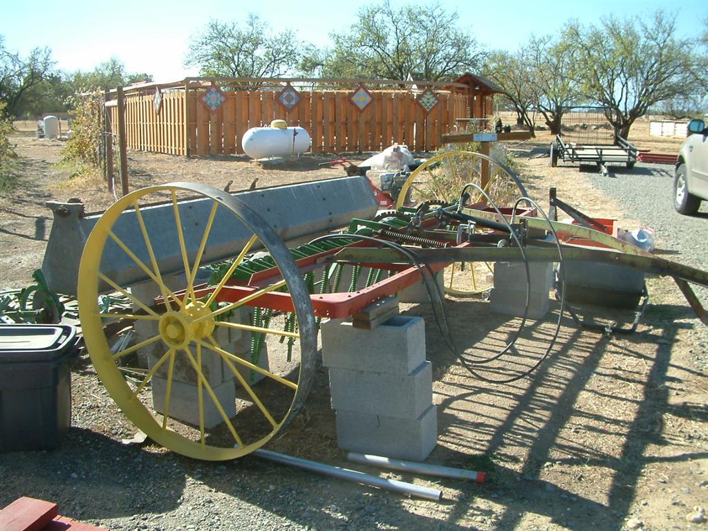

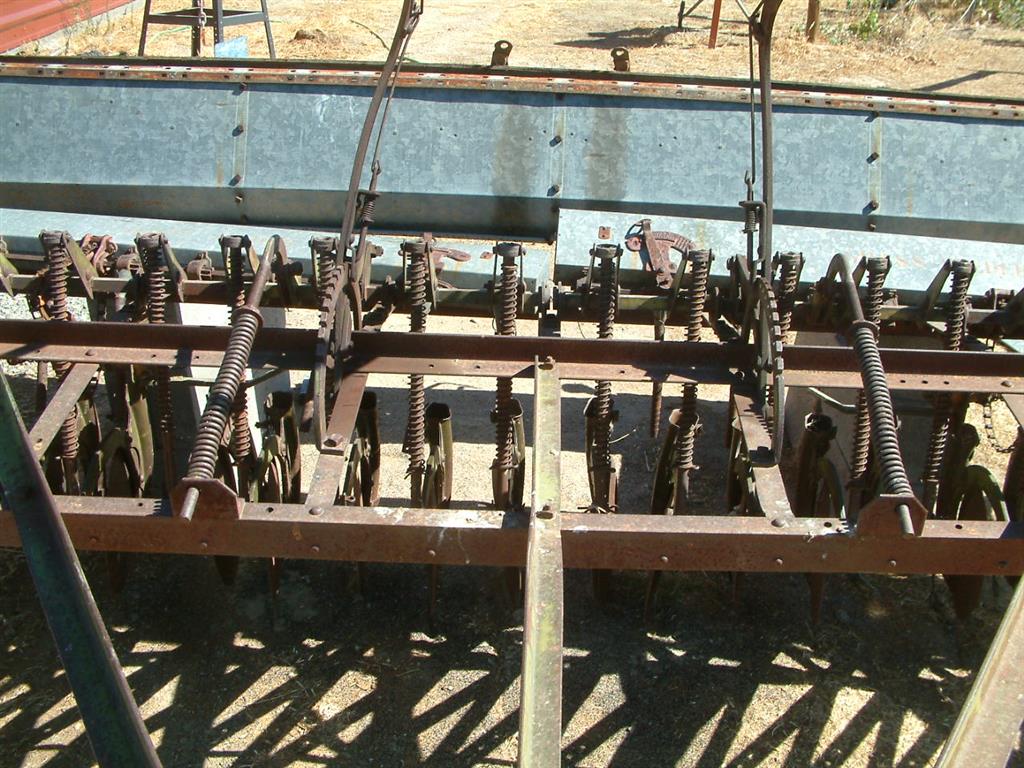

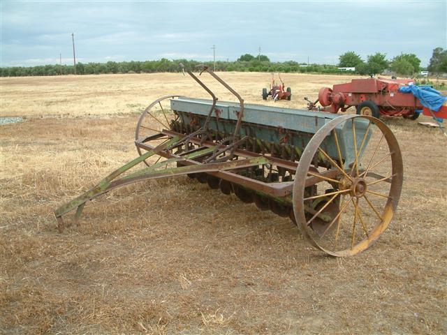

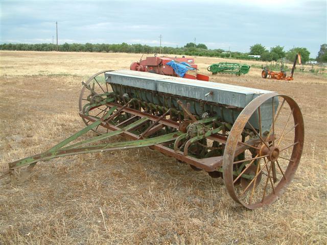

About 8 years ago I bought two old Minneapolis Moline P3-6 grain drills from a neighbor for $275. Ten feet wide, 20 drops, single disc openers.
One of these had a pair of trip clutches to raise the openers when making turns.
The other had a pair of simple levers to raise the openers.
I rebuilt both of them. The one with the trip clutches became a lawn ornament.
I modified the other by shortening the levers and adding a hydraulic ram. My 2008 Mahindra 5525 has triple rear hydraulic remotes.
Hope this gives you some help.
Good luck
