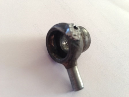

Massey 65
Tractor Experts,
I am in need of some urgent help! during a routine repair, i damaged the fuel off pipe injector connection (see attached photo's). I am unable to find what make or model then injector is and where i can find a replacement part...
Any help or feedback would be greatly received. :)
Thanks
M

   / Massey Ferguson 65 - Fuel Off Line - HELP #5
G'day pretty common CAV injector that outlet should be available from any inj pump repair shop if not then if you have a tractor wrecker nearby check with them they may have an unserviceable engine they can take one off.
Jon
