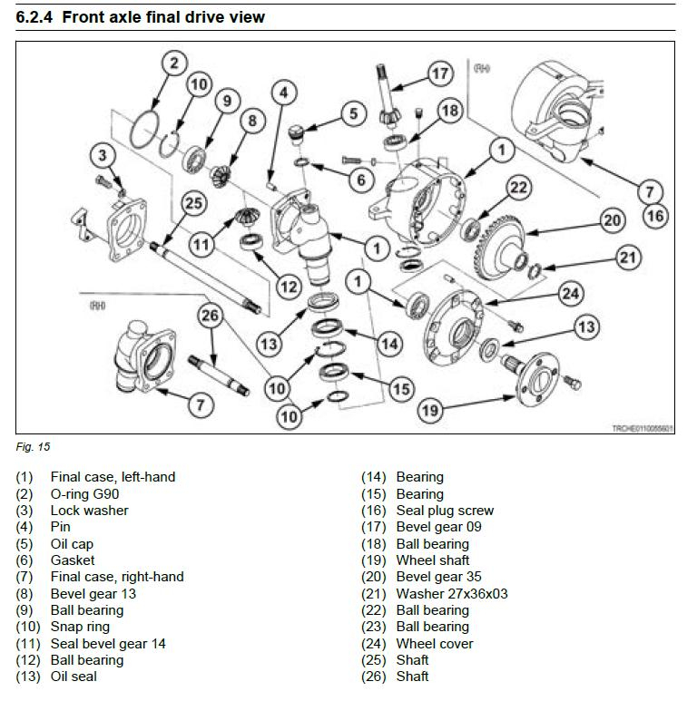

I am hoping and praying someone on here has experience and or a repair manual on how to replace the front axle shaft seal. I think that is what it is called anyways as cannot find a diagram either too know for sure. It is the seal right in the middle of the tractor that is leaking, on the passenger side. I am not sure what all needs too come off to get to this part and how to do it exactly so really looking for some help guys please and thanks. I can take a pic also if needed but after browsing the internet for hours i thought i would post here as I know there is a lot of helpful guys on this website. Thanks in advance for your help!

May or may not help you to determine if you want to tackle job...

Thanks again for all your help now just needing too find a parts book but am looking up another gentlemans suggestion also will reply back thanks.
