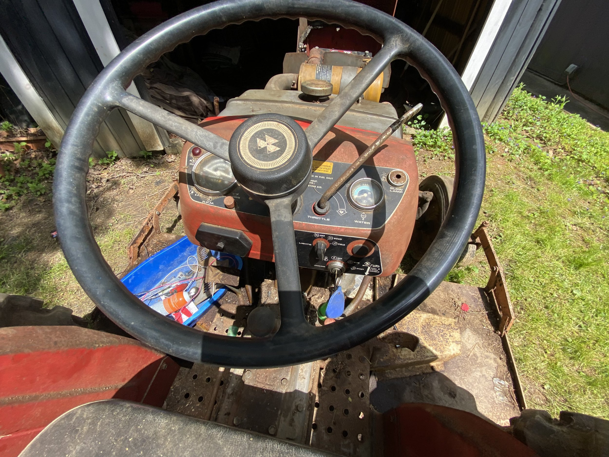

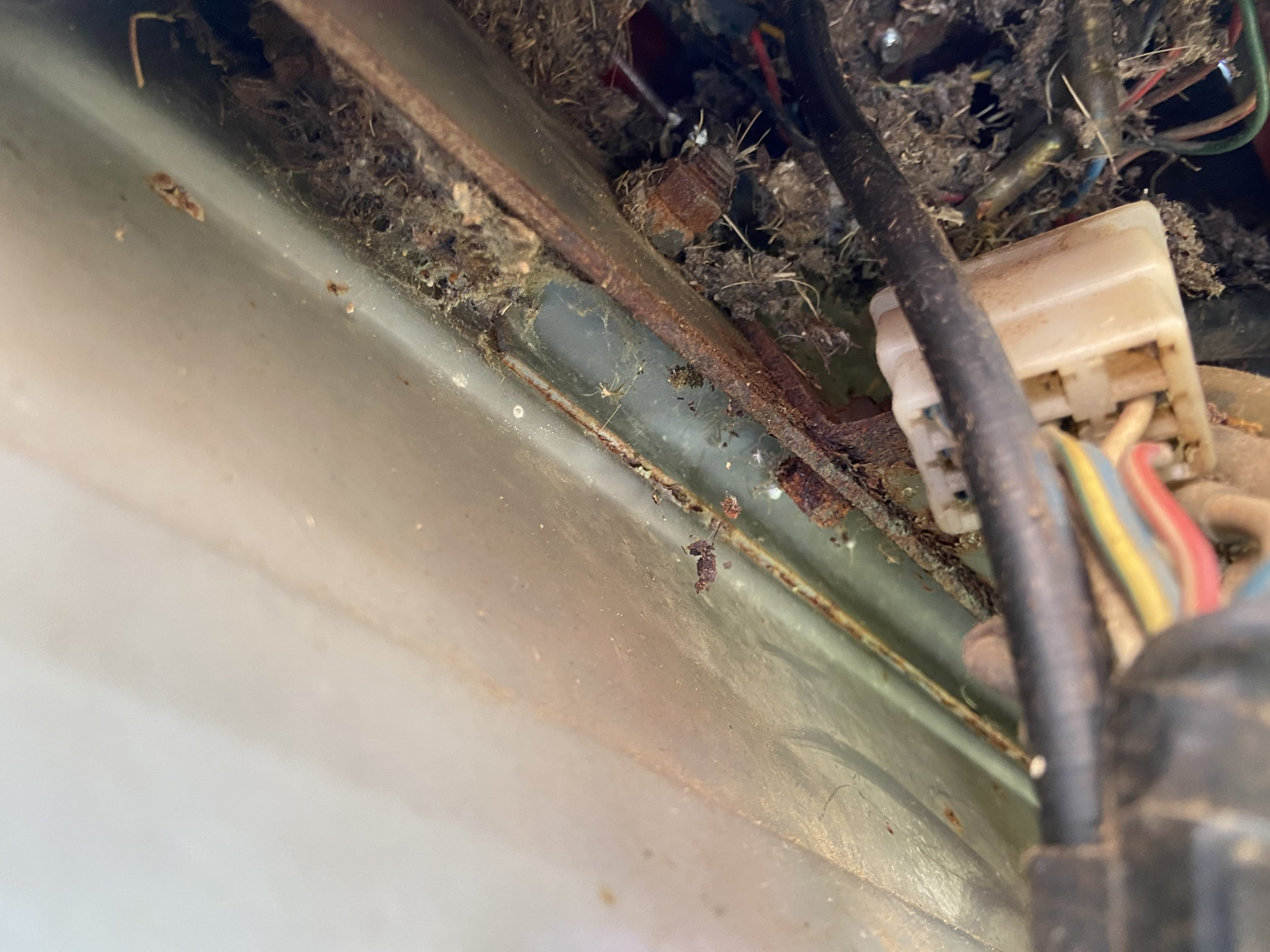

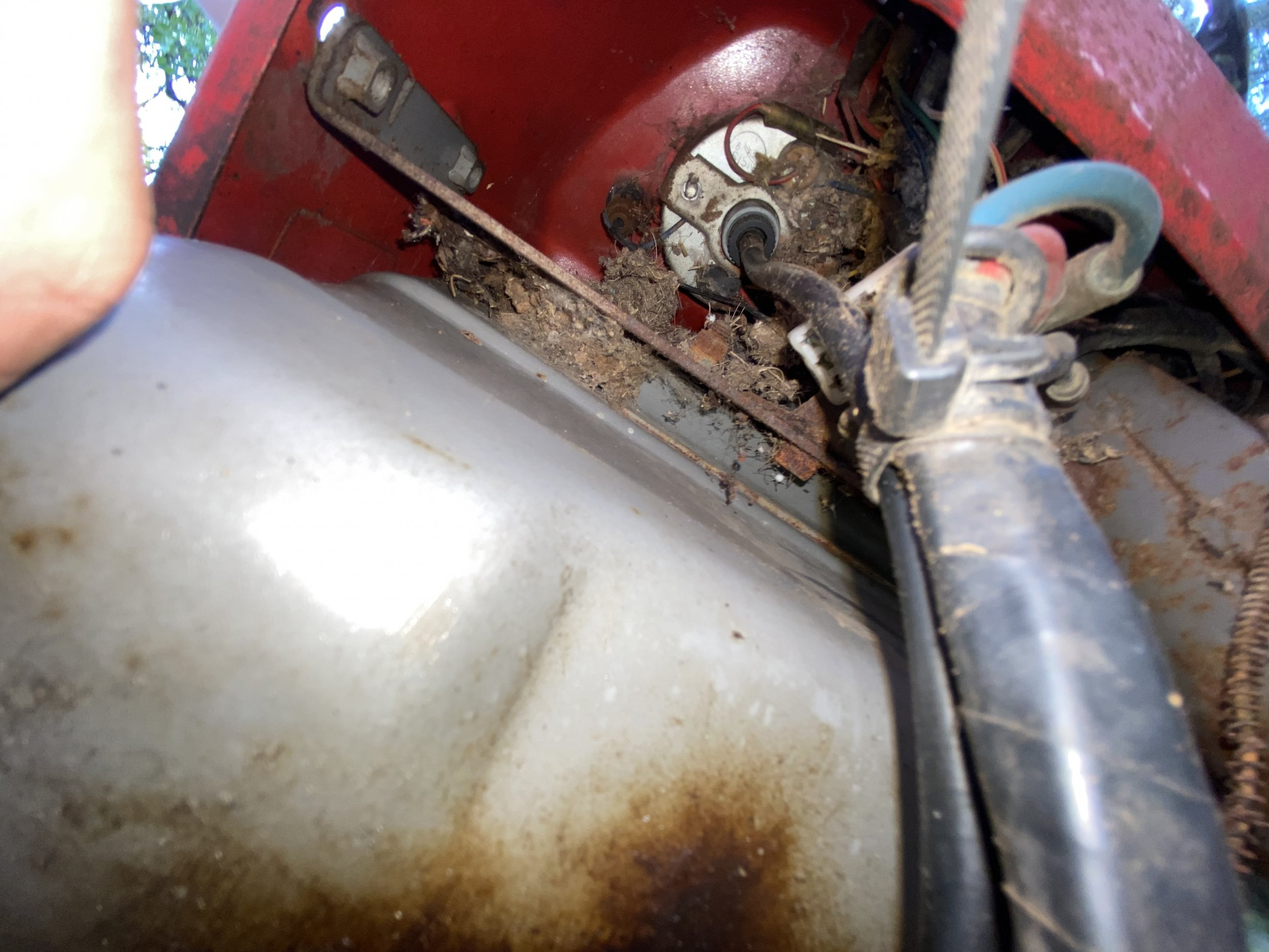

massey furgson 220
trying to get access
to instrument pannel wires behind the dashboard but the diesel fuel tank appears bolted next to it and I need to remove but after removing the 3 bottom screws it didn't move a bit. I'm not sure what bolts i need to remove and i cant even fit my socket wrench in these tight areas.
   / Massey furguson 220 cant remove gray fuel tank PHOTOS #2
Definitely need to remove the bolts in the 3rd picture. You probably need to unbolt the dash cowling and get it to twist out of the way to get access to those. The mount where you removed the other bolts in the 1st picture is probably stuck to rubber isolator or rusted to bracket.
