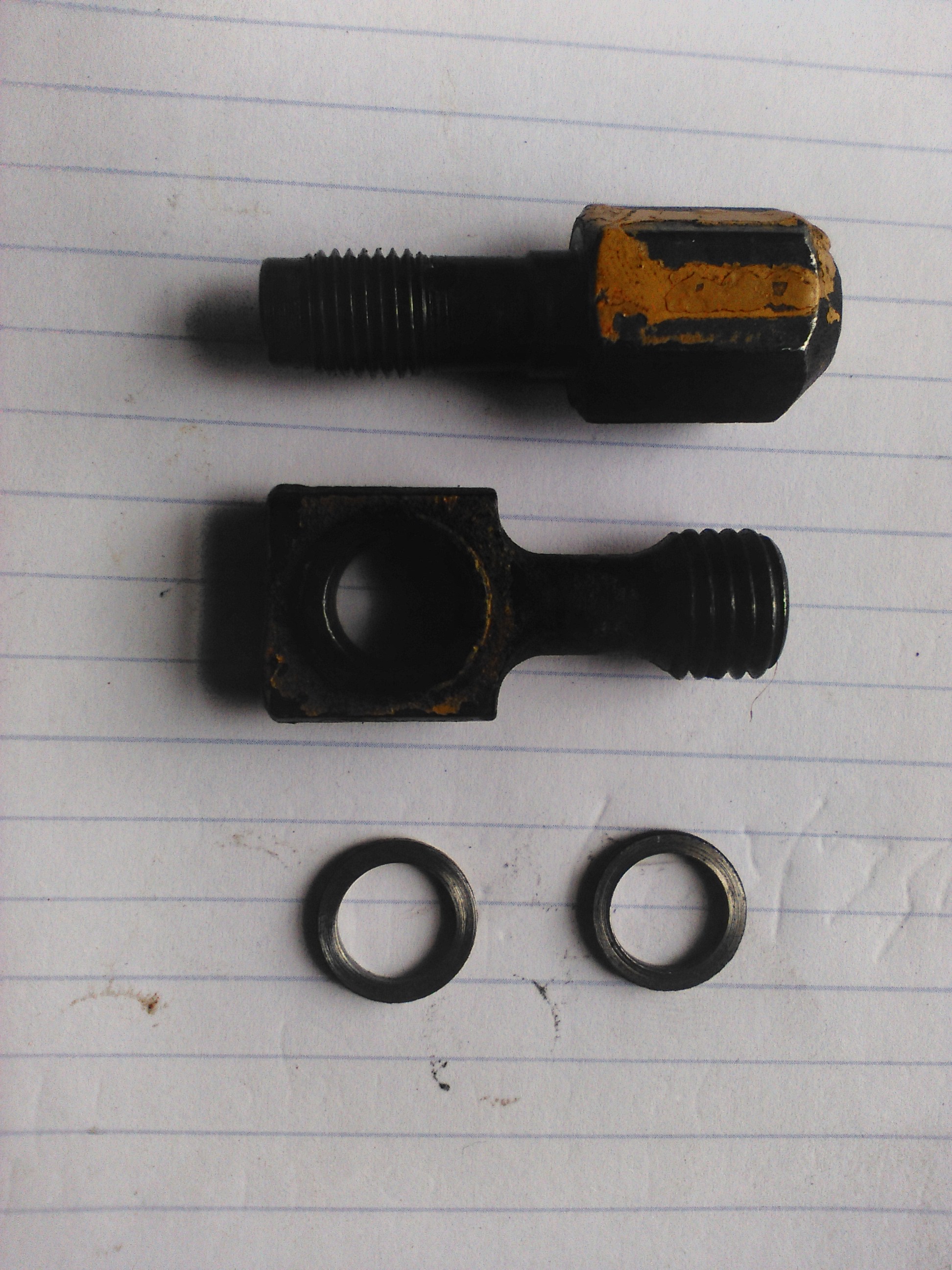

The issue has been resolved. We cleaned the fuel tank and all of the fuel lines with new filters and are now working on the injector pump. Now we are looking for the iron sealing washers for the banjo bolts on the fuel lines on the pump. Can't seem to find them anywhere. Any suggestions?
   / Massey MF 30E engine revs up.
We found soft iron washers. We ordered a kit for the injector pump and the washers came in the kit.

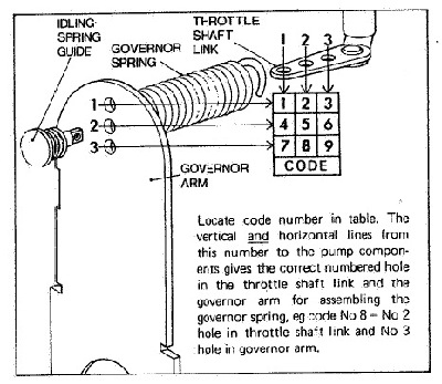

We have replaced washers, seals, gaskets and filter in the injector pump. We are reassembling it. We have discovered the idling spring is missing. Now we are on the hunt for it. Apparently the previous owner had taken it off. The governor spring was in the wrong holes and the idling spring is missing. According to the attached diagram the code number stamped into the injector pump is 6 so on the chart find the 6 and that will tell what holes in the throttle shaft link and the governor arm the governor spring should be in.
