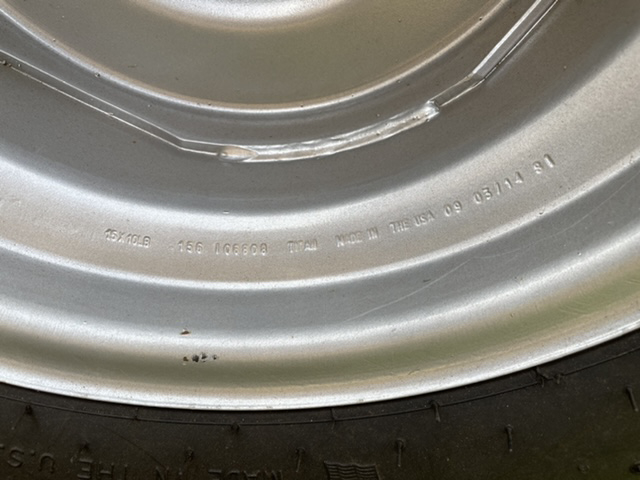

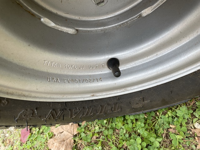

Better late then never. Here’s pictures of front and rear rims with turf tires
