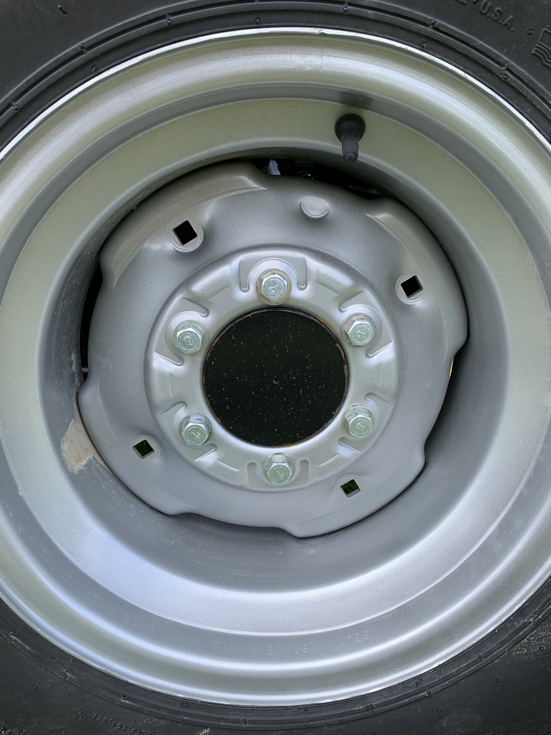

Considering purchasing a Max 26 XLT. I must have AG tires due to my spring seeps, creek crossings, etc.. Dealer has one in stock w/ 9.5 x 16 OEM rear Ag tires so I measured the rear width to the outer edge of the tire TREAD. With the rear wheel installed at the dealer default, the rear outer edge of the Ag tire TREAD is about 46" wide (yes, there is about another inch of rear ag tire bulge on each side which would bring width out to 48" but IMO tread measurement is more representative for my stability so I measured outer tread width).
It would be easy to flip each rear wheel to the other side to attempt to create a wider width, however, the wheel flange that mounts to the axle is welded somewhat offset of center and more to the inside of the wheel (see photo). I am not sure I would gain much width by flipping each wheel to the other side.
So Then I noticed that the max 26 xlt rear wheel is only a 1 piece unit. I can not rebolt/reconfigure the axle flange to the wheel for a wider configuration. (My kioti has a 2 piece rear wheel and I have been able to make significant rear wheel width gains by making adjustments to the 2 piece wheel bolt configuration).

Switch the complete wheels from left to right and right to left. The increased width will be the distance of the lug bolt flange to the wheel weight holes x2 (this is an approximation based on the picture )
   / Max 26 XLT - Anyone make their rear Ag tire/wheel wider? what are my options?
TY VQ. that was my first idea. I have flipped wheels on other units in the past with good success. However, I noticed that the entire lug bolt flange is welded off center to the actual wheel. If you look at the 4 sections where the lug bolt flange is welded to the actual wheel, they are not welded in the center of the actual wheel. They are offset all the way to the inside of the wheel.
So for example looking at the exact spot where the entire lug bolt flange is welded to the wheel, I am guessing that the wheel has about a 6" width/depth. Well, the entire lug bolt flange is welded about 5" deep, toward the inside of the actual wheel, instead of being welded at say may 3" depth (centered) on the actual inside of the wheel. those 4 lug bolt flange welds seems to be about 2" toward the inside of where the lug bolts attach to the axle hub. Its a concave wheel between the lug bolt area and where the flange is welded to the actual wheel. So I am not sure I would gain any width...? Hopefully I am explaining it well.

One other option would be too remove the centers and then reweld them to get the desired spacing.

Get rid of the welded wheels and get some 2 part component wheels. Then you have 4 options for wheel center width: 2 spider options and 2 wheel rim options. If you are that concerned about rollover, fill them only 1/2 full. This keeps the c.g. change down and still gets you some traction. I had 28 R1's on 2 piece wheels and just installed 24" R4 on the 1 piece wheel so I understand the predicament. My experience is that the R1's will slide on a sideslope and not lead to a tipping situation. The R4's will because they stick on a sideslope. I changed to get a better range/gear ground speed for haying and I got a great deal on the loaded 24's as new take-offs.
I like that suggestion.
From his posted pix I see it as a fairly easy task. *
Heck I did just that on my front rims for my CUT.
*welds appear to be inner where the center edge meets the rim thus easy grind.
If tubeless that could be accomplished with tires still mounted.

Great info from Lou, zz, Piloon. TY! I think grinding off/re-welding the spider(centers) would be more cost efficient than new 2 piece wheels,...and maybe more cost efficient than spacers, not sure.
zz, on my Kioti I un-bolted/reconfigured the rear 2 piece wheel for a very wide base and I do have the rears filled only to 1/2 way plus added #160 of wheel weights each side. I planned to do the same with the max 26 but wished to also widen the rear wheel base in some manner.
