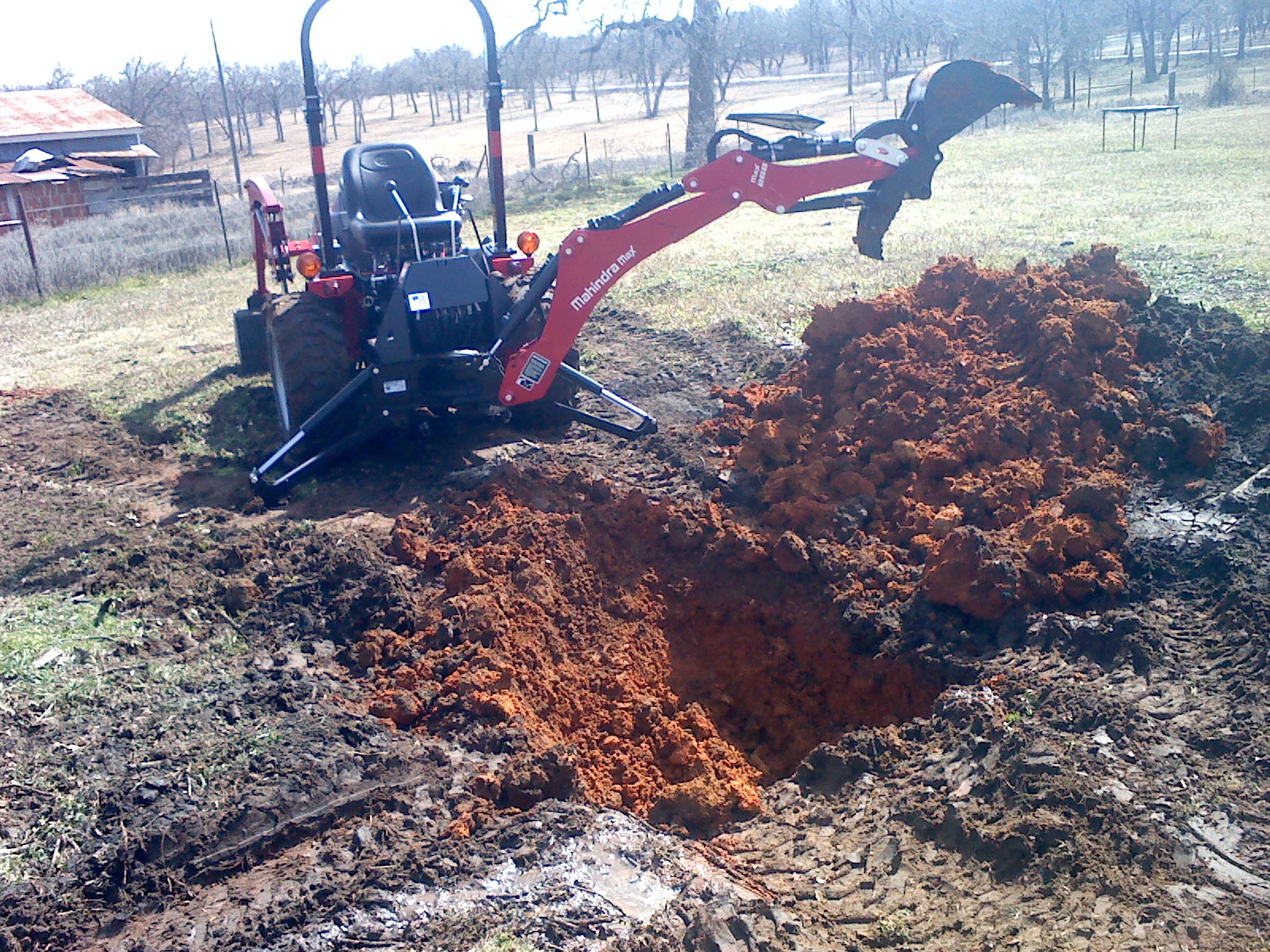

I just got a backhoe for my max 28. It's a Max26b model instead of the M63 that they use to use. I know they had a thumb kit for the old model but do they have one for the new model. I was told no, but when I was pricing it I was told yes there was. Which is true?

does it have eyes welded under the dipper arm? If not, it probably wouldn't have an oem thumb available.
   / Max 26b backhoe thumb question
Yes it does just the boom is serrated where the old one isn't
   / Max 26b backhoe thumb question #4
I just bought a max 26xl TLB and added the thumb at purchase, backhoe model # is 26b
