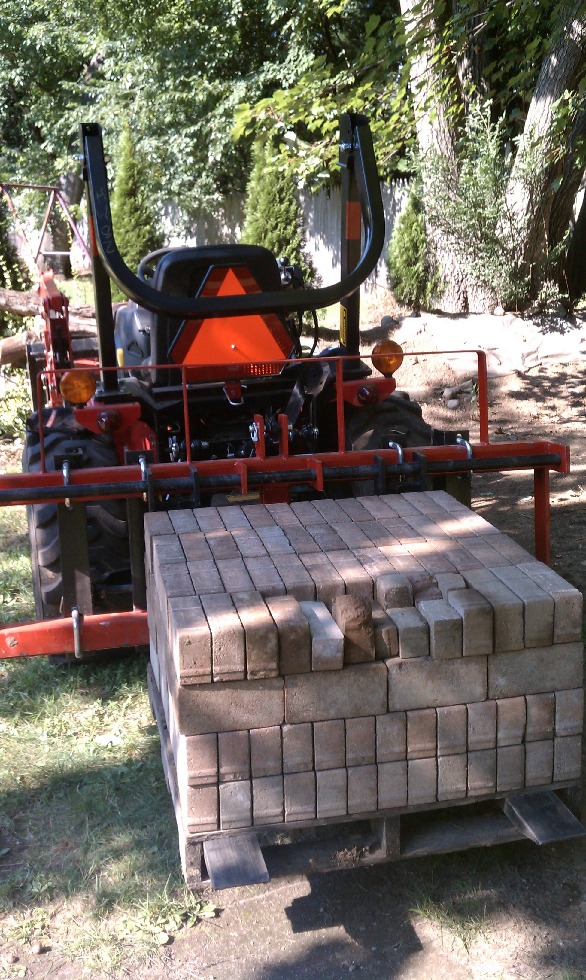

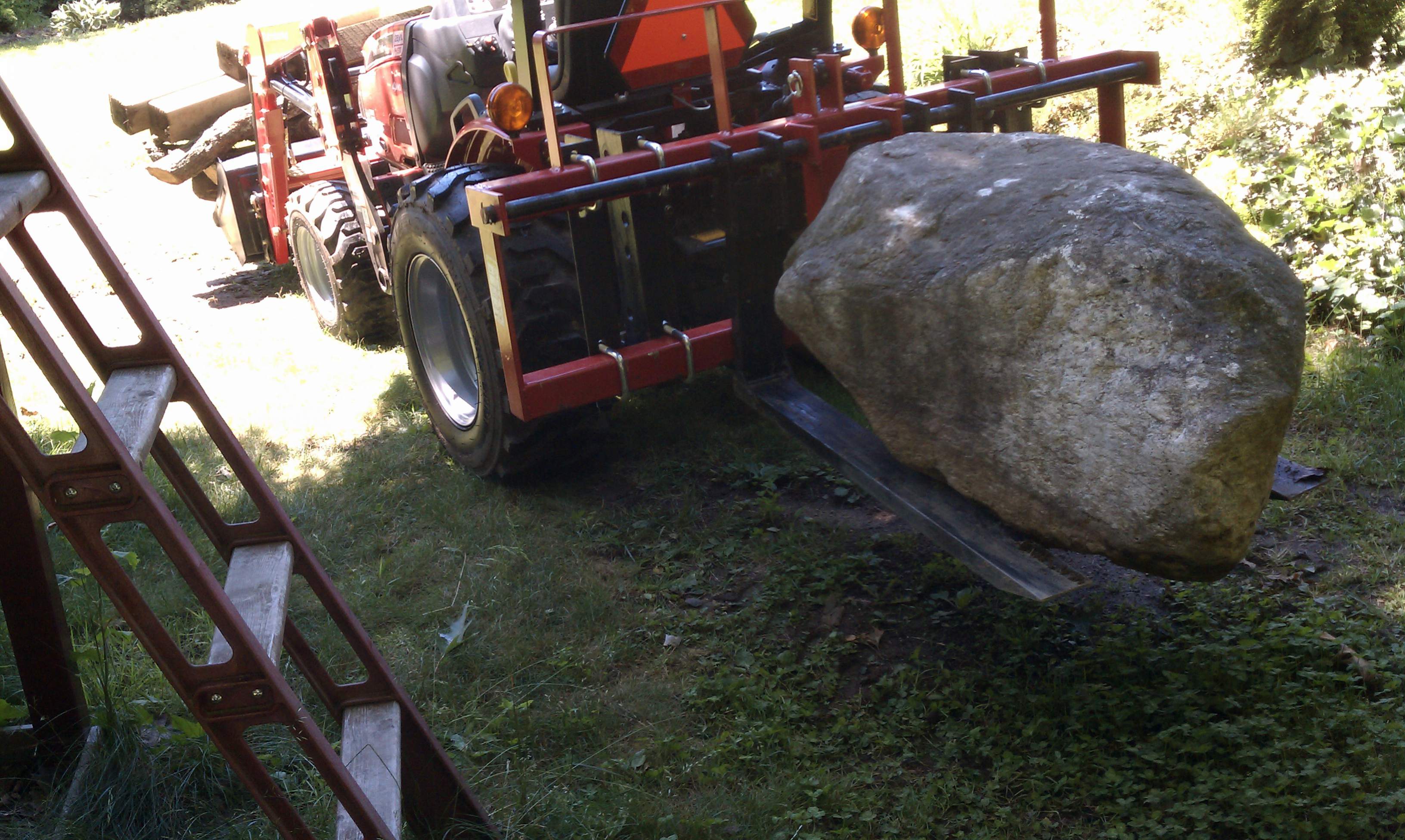

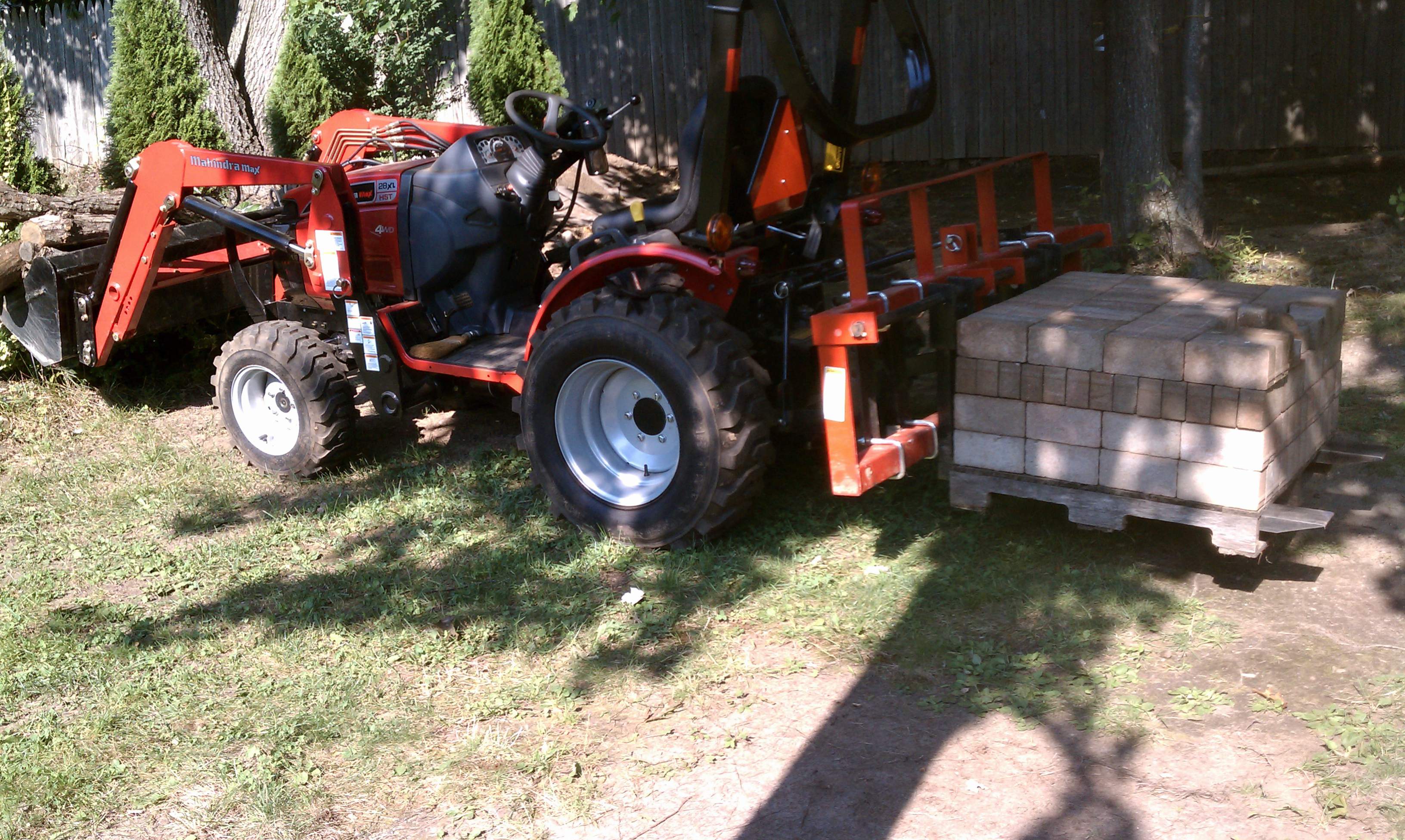

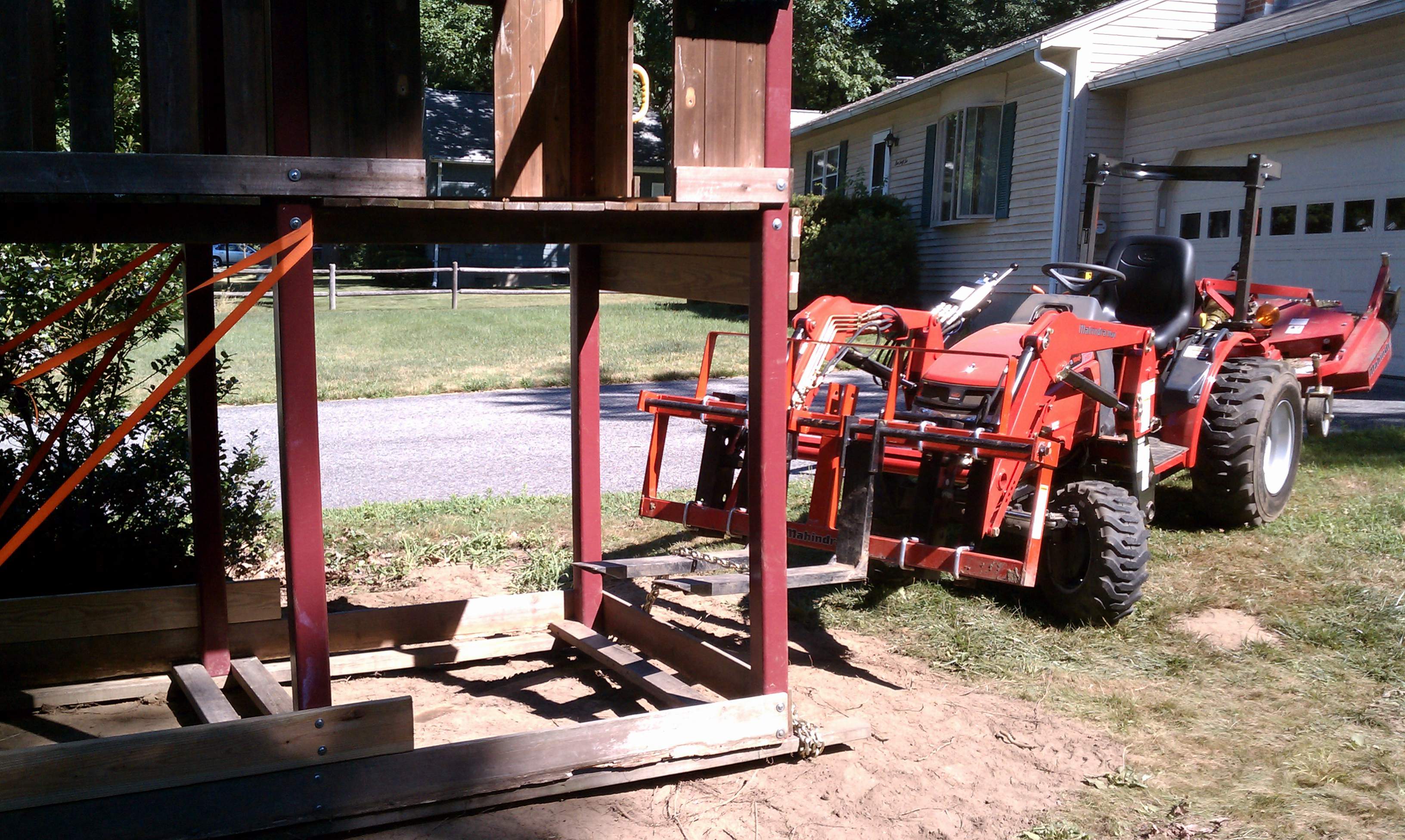

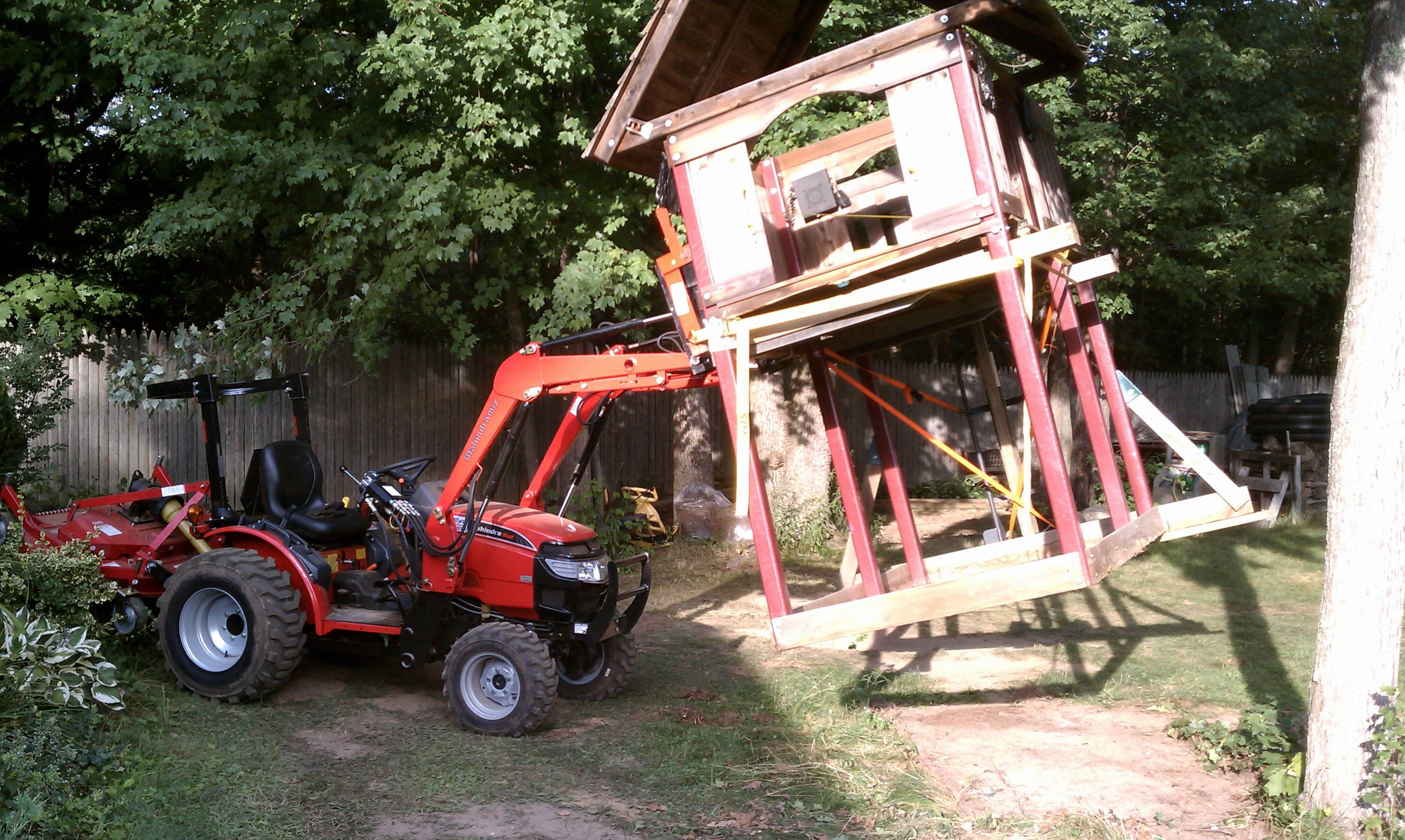

Needed special pins (machined to same diameter as bucket pins), dealer had them drilled to make them greasable. Forks are in this brochure (mine differ slightly): http://www.kodiakmfg.com/products/Kodiak_Implements.pdf
Also available at northern tool:
Howse Pallet Forks for Front-End Loader, Model# SXFLPF-BLK | Skid-Steers Attachments| Northern Tool + Equipment
I've never had SSQA, but that takes 30 seconds. I'm looking at closer to 15 minutes. I've only done it a couple of times, but I think I'll get faster as I develop a system. If you have to switch rarely, then time is not to bad. If switching alot, add up the time it takes you to switch, put it in the framework of an hourly wage, and see if its worth the $1000 to get SSQA
I usually put mine on the back, cause it lifts more and allows the bucket and forks same time.
