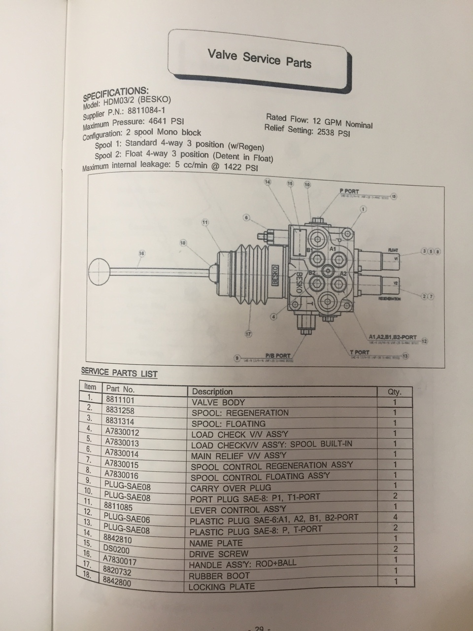

My 2014 hst has a Besko control valve, but the manual for the loader says it comes with a Nimco. I only recently realized this cause a gasket behind the plate at the base of the control lever, crapped out and started leaking. I cant find a replacement part for it. Any help?

2013 with a Besko here also
   / Max 28 Loader Valve Type? #3
2014 with a Besko HDM03/2... IMG_3278.JPG
