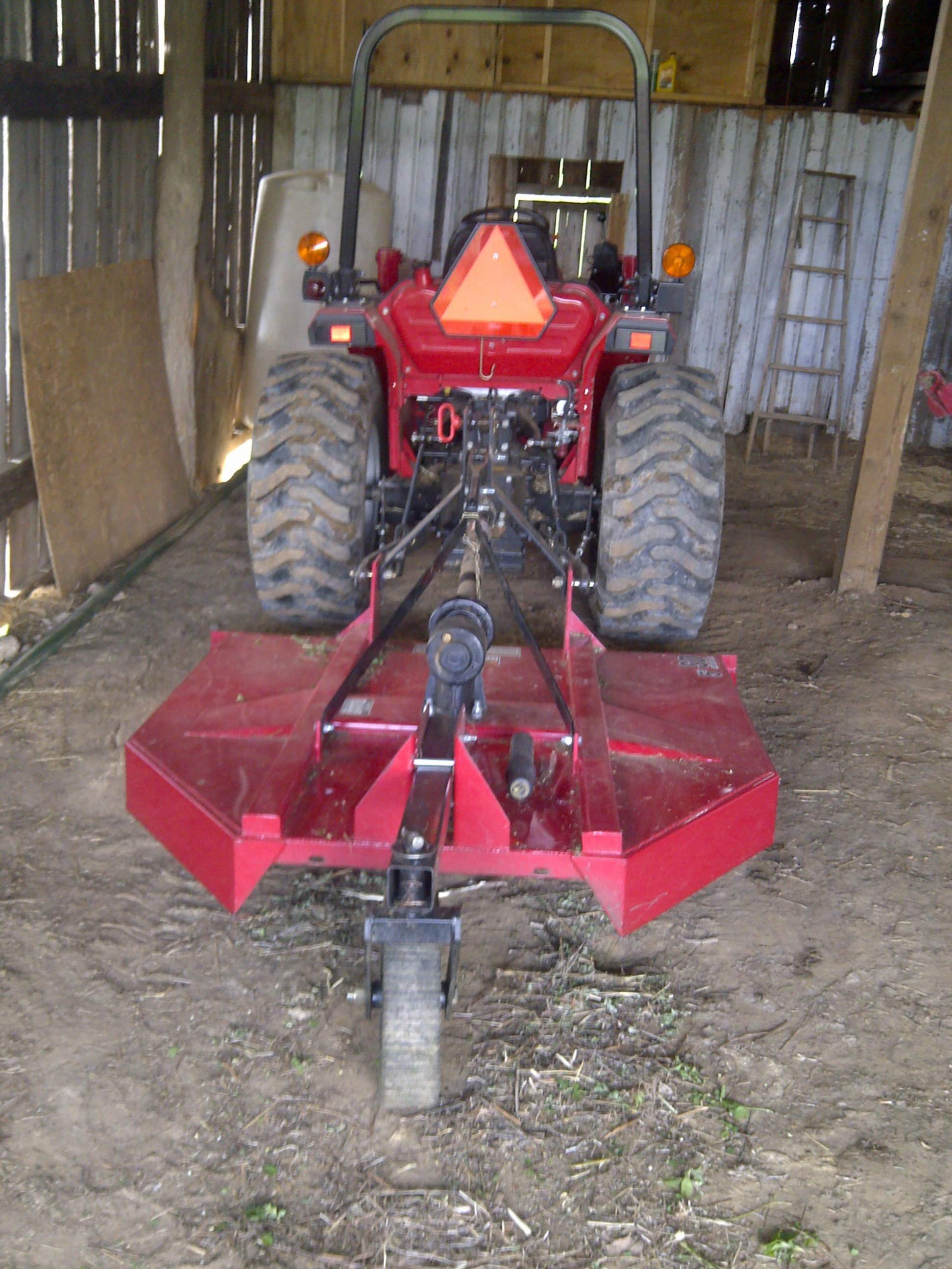

Hi Mark,
While I don't have a Max 28, I do have a 2816 that is similar in spec to the Max 28. The only difference between the Max 28 and the 2816 is weight. You have enough power to run the 5' rotary cutter. I have found 23 PTO HP to be very adequate to run a 5 footer in most conditions. I think the rule of thumb that most use is 5 PTO HP per foot of cutter. The only thing that I see working against you would be the Max 28's weight. I guess it all depends on what type of landscape you are going to be cutting. If it is all flat, then I would say its not a problem, but if you have steep hills, then I might not recommend the 5 footer. Some rotary cutters do vary in weight depending on the robustness.
I have a Kodiak 5 footer with a slip clutch and it specs to weigh in around 515 plus pounds. In most all conditions my 2816 handles the Kodiak just fine, but sometimes if the grass is wet or when am pulling a steep grade, the front of the tractor gets light and will break traction. I leave my FEL on at all times and I have my rear R4 tires filled.
If you were to choose a 4 footer, I can assure you that the Max 28 will make it scream and probably will help you pick up some ground speed while mowing over the 5 footer. Just a thought.
Good luck and let me know if I can be of any help.
Nelson
