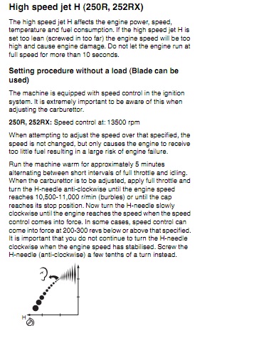

Anybody know the max (recommended) RPM for a 252RX?
Im trying to set max speed. Cant get above 11500 RPM even fully lean...
Manual calls for 13500 as rev limiter speed then -200 RPM for final set. So ~13300 for max speed.
The manual says that the rev limiter can cut in 2-300 RPM under 13500..But im wondering if there was a typo in the manual and they meant 2000-3000 RPM under that would jive with what im seeing?
No matter what adjustment i do on the H needle i cant get above 11,500. It holds 11500 through most of the adjustment. That leads me to believe that 11500 is the rev limited speed.
Can anyone confirm the error in the manual, and 11500 is max speed?

Anybody? I guess the husky subforum isnt getting much attention. I guess ill repost in another section to hopefully get some answers
