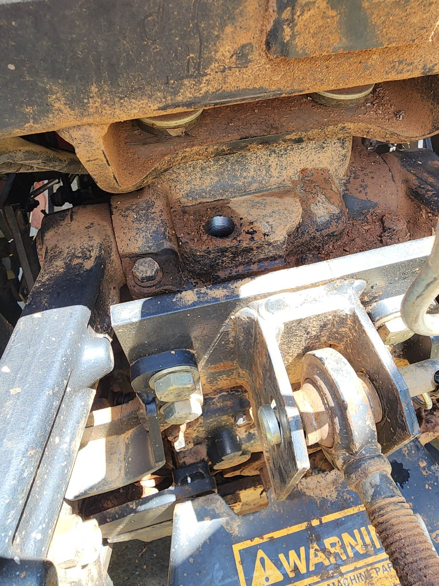

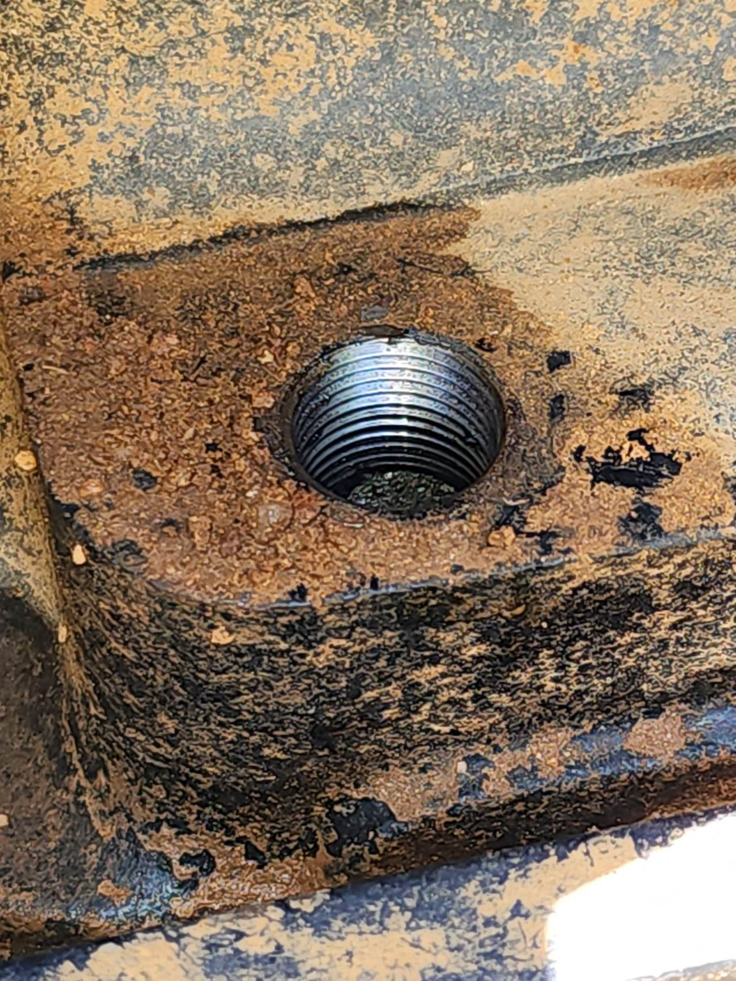

There's a plug on the top of the 3 point unit. I opened it and the 3 point is working. I'm investigating what that is and what, if anything, should go in it, lubricating or hydraulic wise.
View attachment 798377View attachment 798378
that is not removed in my photo's I have never touched it. I strongly recommend you clean the machine before you get dirt somewhere in that system

Good point, I rinsed it off yesterday after spreading the fertilizer and will pressure wash it after I finish my spraying. I don't know why the 3 point started working after opening that plug. I see it in the service manual but there is no reference to it's purpose there or in the operator's manual. The 3 point is still working after I closed it.

you may have introduced some kind of large air bubble, you prolly vented it out of the system doing that. is everything working normal now that you removed that plug?

Everything worked great today with the sprayer over a 3 acre pasture. Now I'm wondering did I really needed to buy and replace that $500 hydraulic pump. I filled the old one with oil and capped it. It might come in handy at some time.
