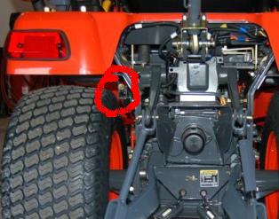

I have a BX2350 with about 50 hours on it. I would like to get the MMM locked in the highest position and still be able to lower the 3PH. From reading the manual, it looks like the best I can do is lock it in the 4" mowing height.
Is there something I'm missing? Or is there a non-invasive modification to do this? I don't feel confident enough to drill holes in my new tractor. :eek:
   / Maximizing MMM Clearance
#2
I finally figured out that there is an adjustment near the left rear of the tractor, which controls how high it can raise the MMM. It came from the factory with this adjustment at the lowest setting, which was a little too low to get the height dial into the TOP position.
I adjusted it to raise the height a little, and now I can lower the 3PH and still have plenty of clearance for the MMM. WooHoo!!

Craig_S said:
Can you tell me exactly where the adjustment is? I'm assuming by the left rear of the mow deck? Can I do it with the deck on?
OK, this is my first time attaching a picture. We'll see if it works. This is a picture I found on the web, and I circled the location of the adjuster.
It consists of a bolt and a lock nut. I had my wife sit on the tractor and raise and lower the 3PH and MMM a few times, so I could get an understanding of what is actually happening to raise and lower the implements.
With the MMM down, loosen the lock nut and then turn the bolt clockwise to increase the maximum height of the MMM. Then raise the MMM to its maximum height and see it the height adjuster will go into the TOP position. If not, lower the MMM, turn the bolt a little more, and try again.
I was concerned that I might raise the MMM too high and damage something, because there's not a lot of clearance between the MMM and the bottom of the tractor. I didn't have issues, but don't blame me if something breaks! :D
Good luck,
Rick
