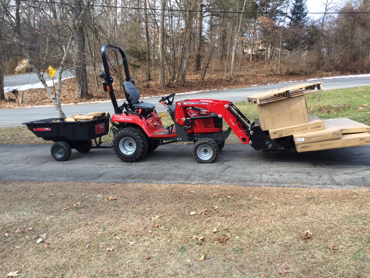

Well i can say i had a good 800 pounds on the loader a couple of weeks ago, I could lift it no problem but i Didnt have the back ho on so the rer nted to come up. I could only lift the load maybe a foot of the ground to keep it balanced.
700 pounds of packages and my debri fork 100 pounds.

IIRC, Axle posted somewhere he tested the DL95 loader with some paver stones and it lifted 900+ lbs... so a significant lift capacity for it's size. Just have to make sure you have enough ballast to lift that much. I am sure with a increase PRV and enough ballast you can reach 1100+ lbs... but that would be max I assume and not to be done on a regular basis.
