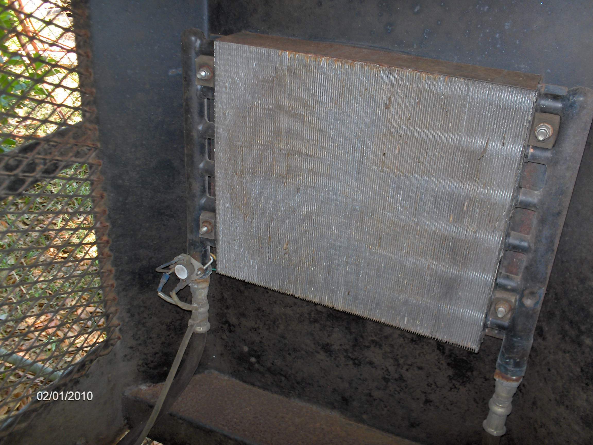

Here is my hyd radiator and fan, it is about 2 1/2 in thick and cools my 20 gal of hyd fluid. It has a temp sensor to allow the fluid to heat up first, and after that it is automatic.
It seems to do an adequate job.
It is a low pressure radiator.

When installing the oil cooler, ensure it cools the return oil back to tank !

I would first check the actual oil temperature as it exits the excess flow port on the Prince valve. The recommendations vary, but anything over 160-180 deg F is undesirable and by 200 deg F the oxidation rate of the oil is much too high and will shorten its life significantly.
A quick rule of thumb is that the temperature of hydraulic oil passing through a pressure relief valve increases by 1 deg F for each 140psi of pressure drop. I assume you are using the valve to keep a constant pressure on the chain and that the chain moves very slowly.
Your Prince flow control valve maintains that pressure on the chain by bypassing the unused hydraulic fluid (which is most of it if the motor is barely moving) through an adjustable orifice at the same pressure that is required to move the motor.
Suppose you need 1,000psi on the motor to give the downward pressure you require. That means the excess flow from the Prince valve is also at 1,000psi when it enters the valve and then that pressure drops to, say 0 for convenience, as the oil flows through the valve.
The 1,000 psi pressure drop in the excess flow through the Prince Valve means the excess flow temperature increases by 7 deg F each time it passes through the Prince Valve (1,000 divided by 140 = about 7 deg F).
So, if your pump capacity in gpm is such that all the fluid in your system circulates as excess flow say two times per minute, then your fluid is increasing in temperature by 14 deg F per minute. Of course, some of the heat energy is dispersed through the cooler, lines, etc., but I doubt that your system was designed to remove that much heat.
Note that this is the sitution when the motor is moving, but only slowly. When the motor stalls, the Prince valve blocks all excess flow (it is trying to force fluid through the stalled motor) and then 100% of the pump output passes through the relief valve built into the Prince valve (or system pressure relief valve if set lower).
This is one of the drawbacks of any flow control valve that sends only a small part of the fluid through a working circuit such as a motor or cylinder; the rest of the fluid (the excess) must experience the same pressure drop as the working fluid. So the control valve is in many cases just a big fluid heater. Indeed, Caterpillar says that the way to warm the hydraulic fluid in my bulldozer to operating temperature for testing is to hold the blade control lever against the stop so that the fluid flows through the relief valve once the cylinder extends fully.
The excess flow line from the Prince valve should go directly to the tank, so it will be under very little pressure. You may need a hydraulic cooler and fan in that line to keep the temperatures down.
