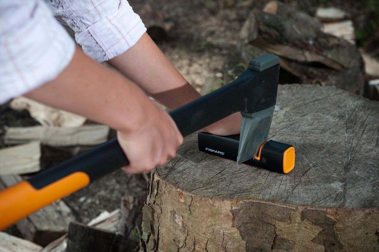

   / Maybe a little OT, how do you sharpen your ax? #7
When this isn't an option
I do it myself
Sirisly though, Fiskars has a tool specifically for my axe, when the time comes I plan to by one.
