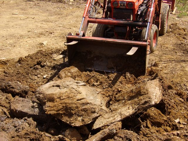

I find raising the back flap also keeps the smaller rocks from bouncing back into the tines and jamming. The worst tines for breaking were the outside row getting jammed by small rocks so I removed the outside row of tines. Seeing as I only had minimal horsepower this saved tines and made things easier on the tractor.
Also, as stated, allowing the tiller plenty of sway room seems to help when the big rocks are found.
If one is real serious about getting rid of rocks before tilling use the front forks to spade the garden. Brings all kinds of good stuff up!:D
