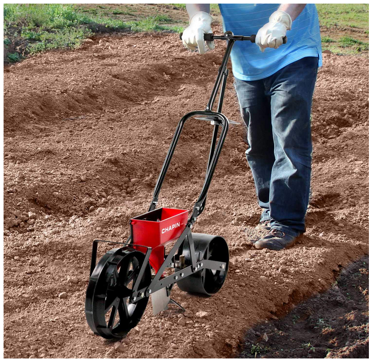

But what i don't know is how do I get the seeds in the ground if i don't till first? I typically make a trench in the powdery dirt, walk along dropping seeds in it, then lightly rake over. All areas together are maybe an acre, so not terrible amount of effort. But too much to do by hand wihtout the tilled up soft dirt I can easily trench & recover. How does something like this work? Does it dig in & bury the seeds or do I have to have tilled, powdery dirt, it can "plow" to get the seeds at depth?
https://www.amazon.com/Chapin-8701B-Garden-Varieties-Package/dp/B06ZXWTFPY
I'm definitely not planting enough that I could justify some 3PT tractor implement to put seeds in the ground. Kind of in-between (did 4k corn seeds, 600 squash seeds, will do appx 1k pumpkin seeds) where I need some type of tool/way to make it easier, but not enough volume I need some expensive attachment or tool suitable for 40AC field....

The seeder in that picture will not open furrow in soil unless it has been tilled first. Can you fertilize and till/plow a 12" strip while leaving ground between rows untilled? Many growers till the field,plant pumpkins in hills far enough apart to alow plowing in checkerboard pattern before vines spread if needed to control weeds.

They have been in come use by farmers for years so finding the planter at salvage yard and fabbing a tool bar would give you a versital planter that will open furrow for no til planting.

I'm only commenting on your proposed schedule and procedure;
the roundup needs to be applied to growing vegetation.
If applied after brush hogging/ mowing before the regrowth starts it will not be effective.
As far as tilling your soil after weed control, if your soil is not compacted a narrow set of cultivators or a couple danish tines on a tool bar would do good.
Or if you can remove most of the tines on your tiller and just spot till for each seeding.
Also can you plant your pumpkins between your corn rows?
You could use brush or rope wick applicator to spot apply your roundup while the corn is still growing.
