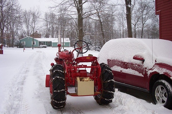

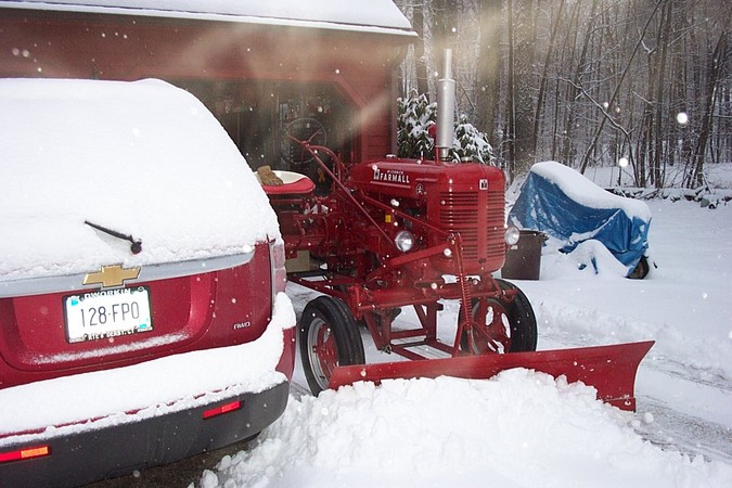

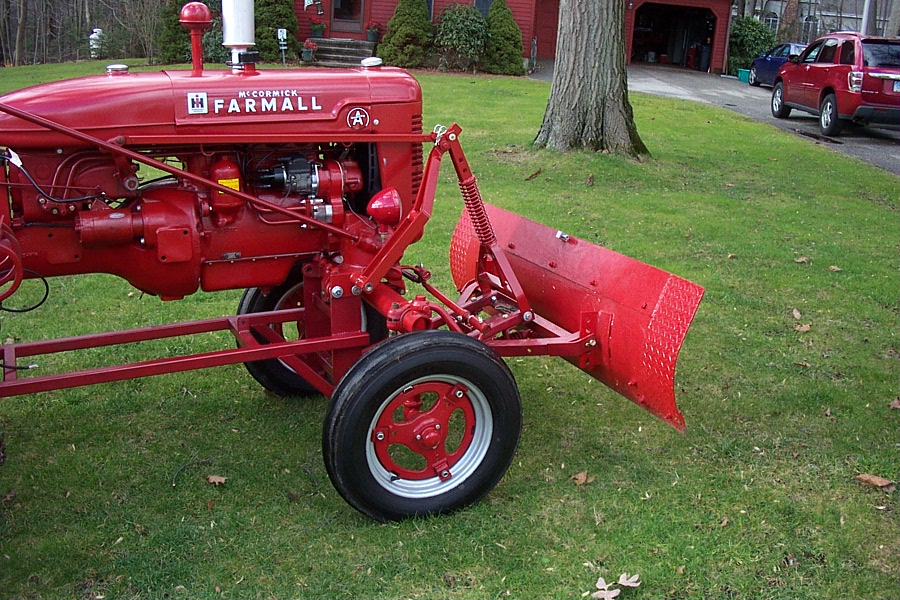

Mornin Tater digger,
Well to begin with that blade was originally mounted on the Farmall off of the cultivator mount. They worked well but personally I never liked the design because of the strain it put on the front steering box and bolster ! After I finished restoring my Super A I wanted to put the snowplow on it. I ended up fabricating a frame that goes from the rear final drives to the front cultivator mount. This also takes a lot of stress off of the torque tube while plowing.
Back to your original question your tractor is probablly beefy enough to handle it, but this is what I ended up doing. Enclosed are some pics ! Good luck with it. And BTW if you have all the hardware for that attachment its worth some $$$$$ !!!
