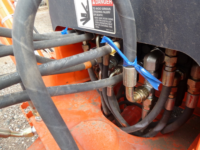

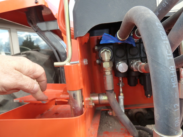

J J Herewith are pictures. The blue ribbons mark the input and outlet for the thumb hydraulics. Hand is on the foot pedal.
I don't know why the input comes off the supply line from the tractor, rather than the supply side of the valve. (I know there's a reason, just not what?)

dfkrug, I'm thinking about the dual pump configuration. The hoe has three hoses from the tractor, I assume two inputs and one return. The two input hoses are on the right end of the valve block, with the boom swing valve between them. I don't know from following hoses whether boom swing is powered by a different pump than the rest? But if so bucket and thumb are together on the other?

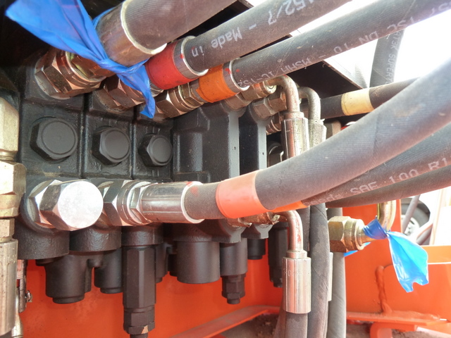

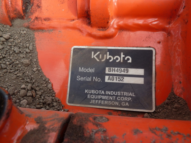

Interesting pix, GRAY. Some surprises there:
I thought he L39/45 used the BT1000 hoe. I have not seen that hoe
designation, BH4949.
Your valve block shows only 3 shock-RVs.
The ribbons indicate the added thumb plumbing, correct?. The tee
into a work port is surprising, assuming that IS a work port. I do
not know your plumbing config.
The thumb control...is it supposed to close when you put your foot
down, then retract automatically when you take your foot off? That
is how it works on the excavator I operated. On your backhoe, that
kind of control is not simple, and may point to your problem.
As I said, I don't know the L39/45. You need to trace the hose
routing and look at the hydraulic diagram in your service manual. One
return line for both hoe pumps is OK.
   / Mechanical or Hydraulic thumb? #24
The hoe is indeed a BT1000; the ID plate is on the thumb.
Are the shock RVs the pointy bits facing down from the valve block?
Ribbons are on the added plumbing. The tee is on the larger of the two supply lines, not a work port.
Function of the foot pedal is two-way: retracts when you rock one way, extends the other way. Come to think of it, maybe that's why it's piped with a live supply and a ported relief?

   / Mechanical or Hydraulic thumb? #25
Did someone use spools for the thumb that had regen on it?
J J, can you expand a bit on this? (See, I'm learning enough to hear the questions!)
   / Mechanical or Hydraulic thumb? #26
I believe they are the longer units hanging down off the valve block,
with the 2 hex nuts at their ends. Check with your manual when you get
it.
Generally, we don't tee off supply lines (pressure IN) in open center
systems. If your added valve is OC (probably is), it has to get its
supply from the power beyond OUT of the last valve in the stack for
one of the pumps, or it goes before that same stack.

It looks like the rod end of the cylinder is piped to one port of the thumb control valve and the other end is teed into the return line. That would do what you say, extend slowly on its own and retract rapidly. With return pressure on the piston side all the time, the thumb would have no power. The L39 does have a separate swing pump. When looking at the valve from the back of the tractor, the main supply hose is on the far left of the valve pack and the swing supply hose is on the far right. The return line, where your thumb is teed in, is between the swing control valve and the rest of the valve stack.
I see in the parts manual for the BT1000 there is a kit for auxiliary hydraulics that is connected just as yours, but it looks to me that the kit was not designed for a hydraulic thumb.
If the foot pedal works the valve in both directions, you could move the line from where it is teed in to the return line over to the other port on the valve, but you should have a relief valve in the line on the piston side of the thumb cylinder. If the foot pedal does not work the valve in both directions you could add a separate detented valve on the outlet of the foot control valve to control the direction of the thumb. Get a valve with a built in relief.
