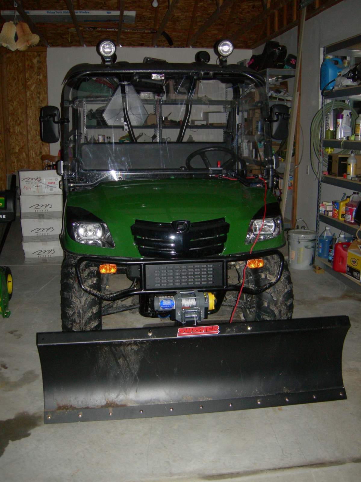

The ride on the Mechron is great and the noise level is low. The neighbors around here were impressed at how quiet it is. I don't plan on driving it on streets but did add lights (stop, running, and turn) along with a horn just because I couldn't see all the wiring going to waste. Work lights were added, the bed was coated with Line-X and a snow blade/winch will be on within a week.

Mine has Armstrong power steering and it works real fine. I do wish the heater would put out a bit more hot air on the cold days...
I got the snow blade on this weekend and it did a nice job pushing some old snow around. I'm ready for some fresh stuff.
