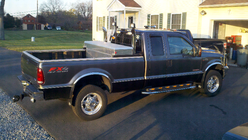

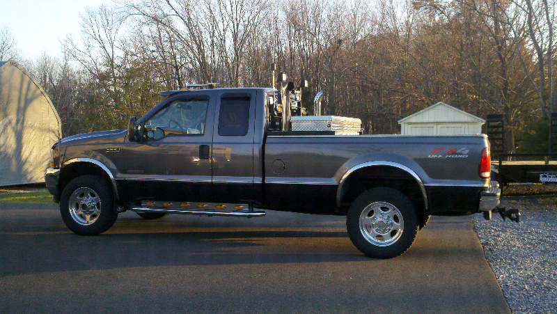

I run those Michelin XDE's on my F350. 245/70 R 19.5 LRH. I have over 60,000 miles on them however it is a lighter truck then international 4700. I always had good luck with them in the snow or mud.

:thumbsup: That is a sharp looking rig powerhorse!
