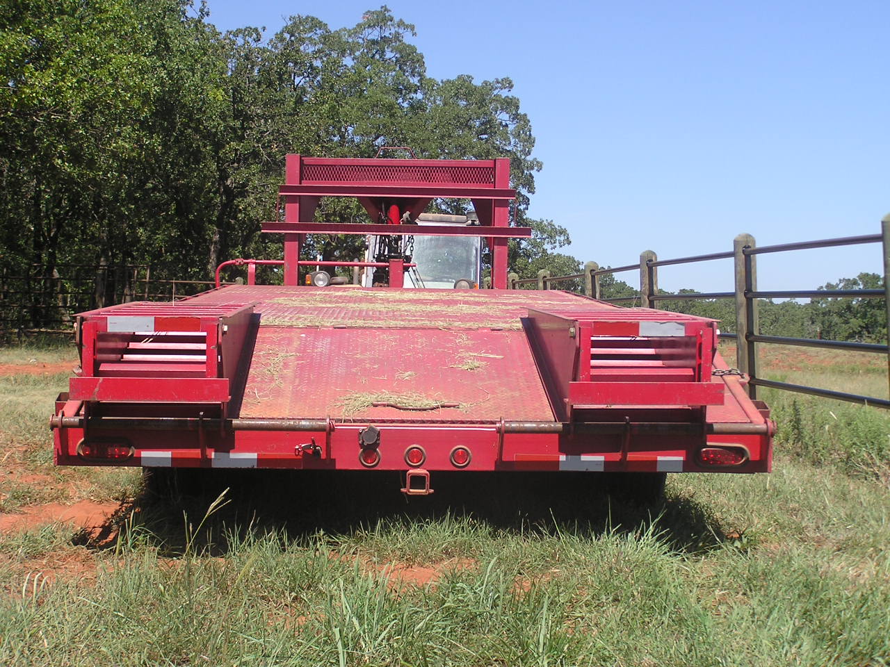

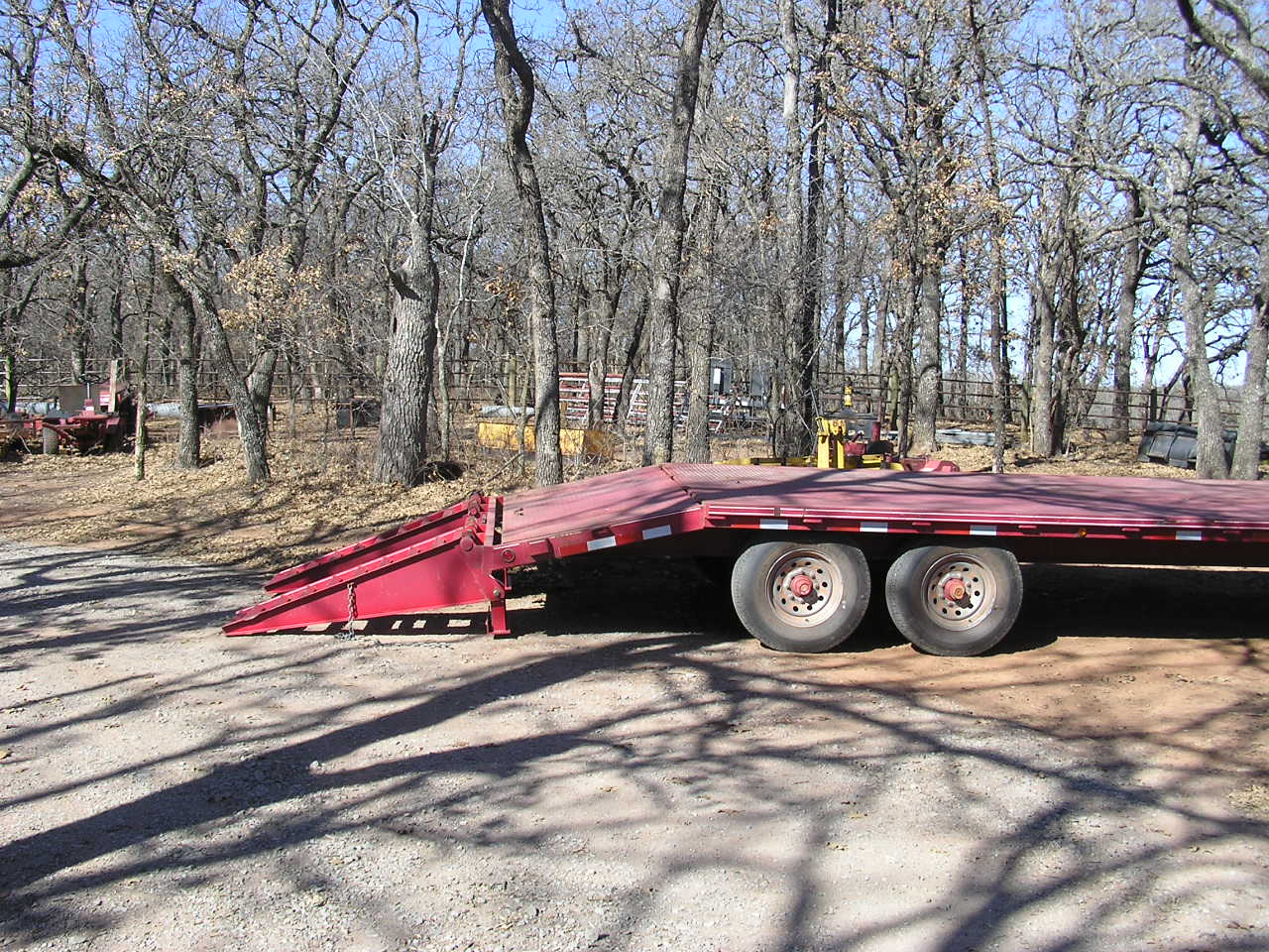

Since you are in Arkansas, check with Delta: Welcome to Delta Trailers
I have the 18' plus 4' lift up dovetail. Ordered in 2006, from a local dealer and drove to the factory to pick it up.
