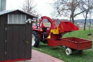

Hi Cliff
Just wanted to put my 2 cents in. Here's my 6" jinma (Chinese) chipper. It's got about 20 + hours on it, doing good so far. I burn wood, and only run 2" limbs or so through it.
Yugo
