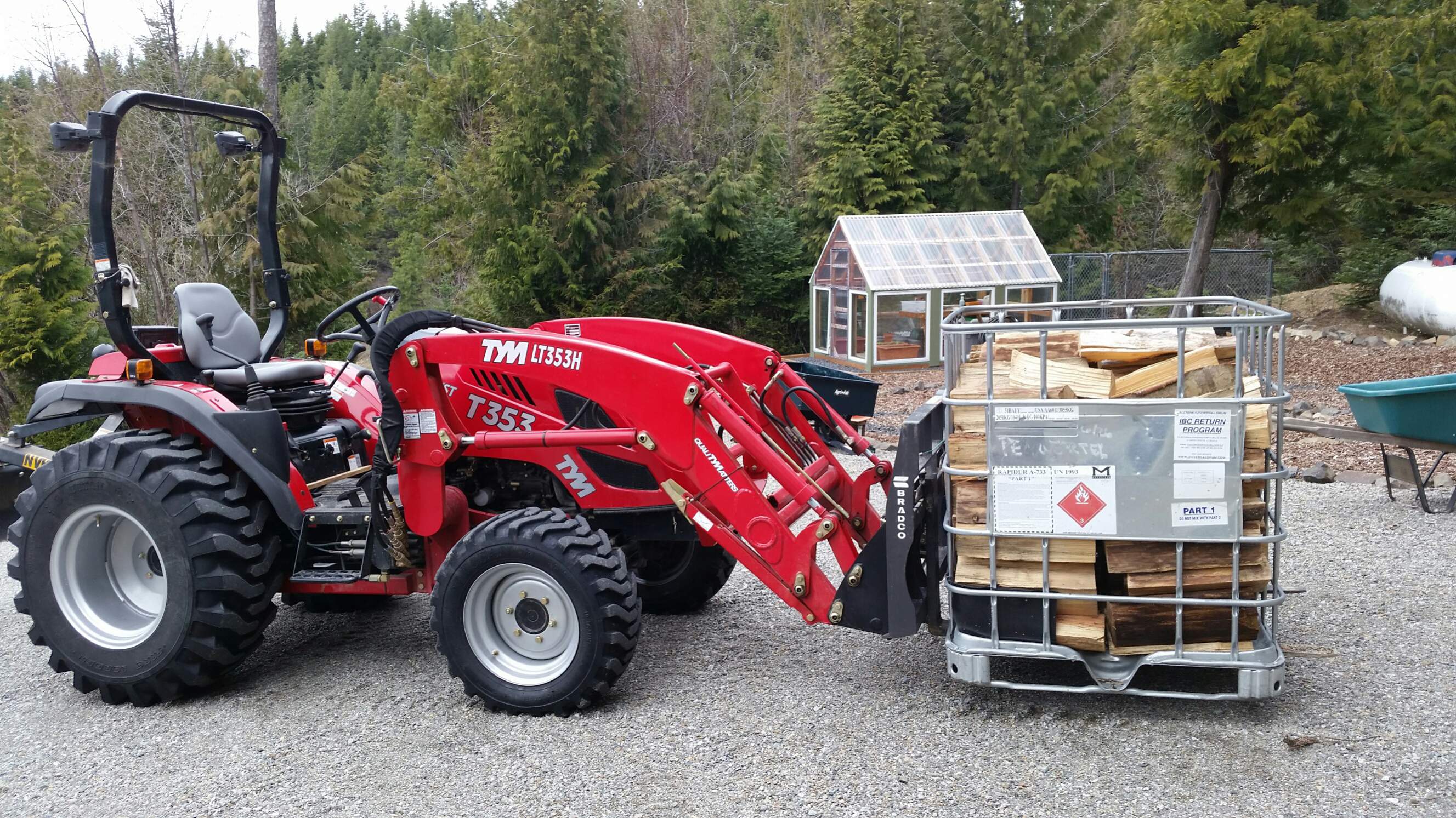

FWIW, Joey's tractor will lift either 1241 lbs or 2235 lbs at the pins to full height depending on which model of loader he has on it.
Parkanzy - My loader will lift 2235, I have no problem with the full tote of firewood. In the pic it is about 4 inches off the ground, I like to keep my center of gravity low.
