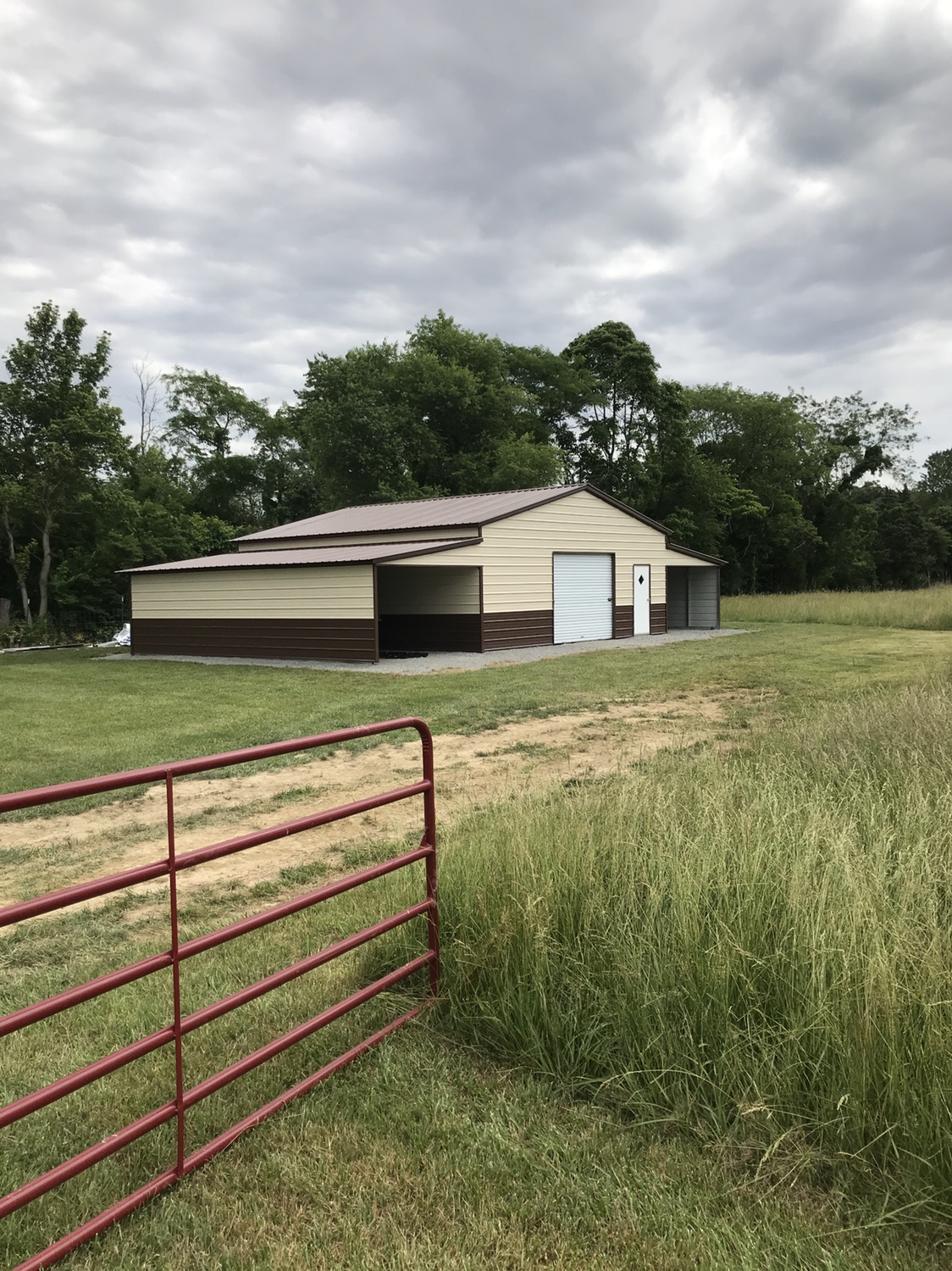

I have a 30x30 metal building with 12' lean to's on either end making it 30x54 under roof. To build myself was only 10% less on the price so they had it completed in under 2 days.
I like the barn and it's now 3 years old. No issues. I plan on building another this year so my cattle and feed/hay/straw and in the first and the tractor/implements/fuel will be in the new one.

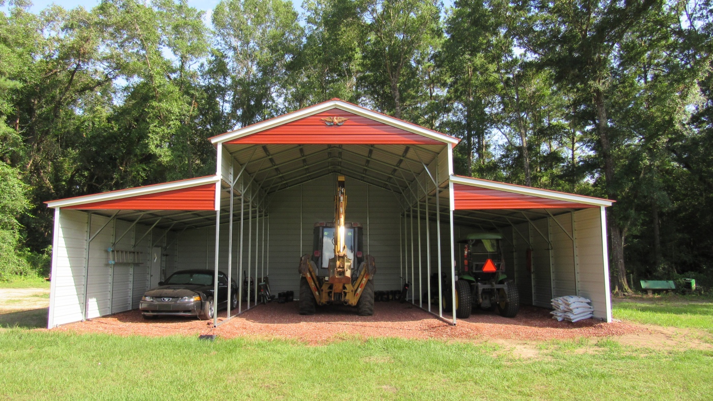

I had a 32x42 open front built last year by Carolina Carports. They were running a sale and I got it put up for under twelve grand. I leveled and packed the surface and used crushed red brick for a base. They do not offer site prep so you have to have it ready before they will schedule. I probably have $1000 - $1500 invested in that. I added a load to level out the inside and make an apron on front since this picture was taken. Two guys showed up and had it finished in two and a half days.
Something I would have done different if I were doing it over is I would have the lean to panels cut longer for a extended eave. When it rains the crushed brick absorbs the water and it gets damp inside. A few days of sun and it's dry but I would rather the frame work wasn't sitting on top of the wet brick. I'm not sure if there is any way to prevent this with water hitting and running down the sides and back though.

Oddly enough my roof metal extends 8" past the walls. Bad for gutters but good for run off. I put down 4-6" of crushed limestone so i never have water inside.
   / Metal vs Wood Pole Building #6
My eaves probably come out that far. I imagine water seeps into your gravel as well but mine being crushed red brick it darkens when the water gets under it.
I tried to mitigate one side by putting down a plastic sheet that came up a couple inches on the side and out 3 feet but the rain that blows against the side of the building still causes it to get damp. I don't think gutters would even help in a blowing rain situation which is common.
